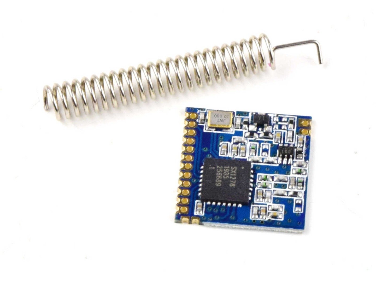

i have this module:
and Arduino Mega.
i want to connect:
two nodes as transmitters (each with sx1278 LoRa module connected with Arduino Mega and sensors like (MQ5 and Flame) sensors connected to the Arduino Mega), these two nodes send to base station node (Receiver) also with sx1278 LoRa module connected to Arduino Mega, this station get information from the two nodes (Transmitters).
it appears to use an SPI interface similar to the link in post #4
connect it to your Mega instal the Lora library and try some examples,
e.g. File> Examples>Lora>LoRaDuplex
you may need to change the frequency
the program tests for the Lora board and will tell you if found or not
