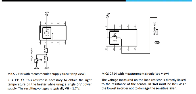

As described in the datasheet and the sensor schematic, that pin enables the heater, which is an essential feature of the sensor. The heater must be operating at the correct temperature or the readings will be meaningless.
Most sensors of this type require a burn-in period before valid readings can be made, (in some cases up to 72 hours) but the data sheet doesn't seem to mention this. Study all the available literature, and if necessary, contact the manufacturer for more information.

Brilliant thank you. I had it originally connected it up via the PWM pin (Pin 3), as I thought it was the preheating pin. On the manufacturers website it's connected via PWM. I started to doubt myself though, as I struggled to see any difference when it was connected or not. I now realise I haven't been letting it preheat for long enough.
Would it be okay to simply connect the 5V power source to the pin, as according to the data sheet there's a resistor built into the sensor which would reduce the voltage to 1.7V when it reaches the heater:
Or is there some reason for using the PWM connection which I'm missing?
Thank you kindly for the aid so far.

Unless you use the Arduino PWM function, the PWM pin is just a digital output.
No worries. I was originally using the PWM function to deliver an average pulse of 1.7V. I then changed the code, so the max voltage it delivered was 5V instead.
I will just connect it to the main 5V power supply for now and see how it goes.
Thanks for the help again, it's greatly appreciated.
Why?
It was a mistake originally. I had established that the heater needed 1.7V, I missed the fact that it had a built-in resistor to achieve this.
