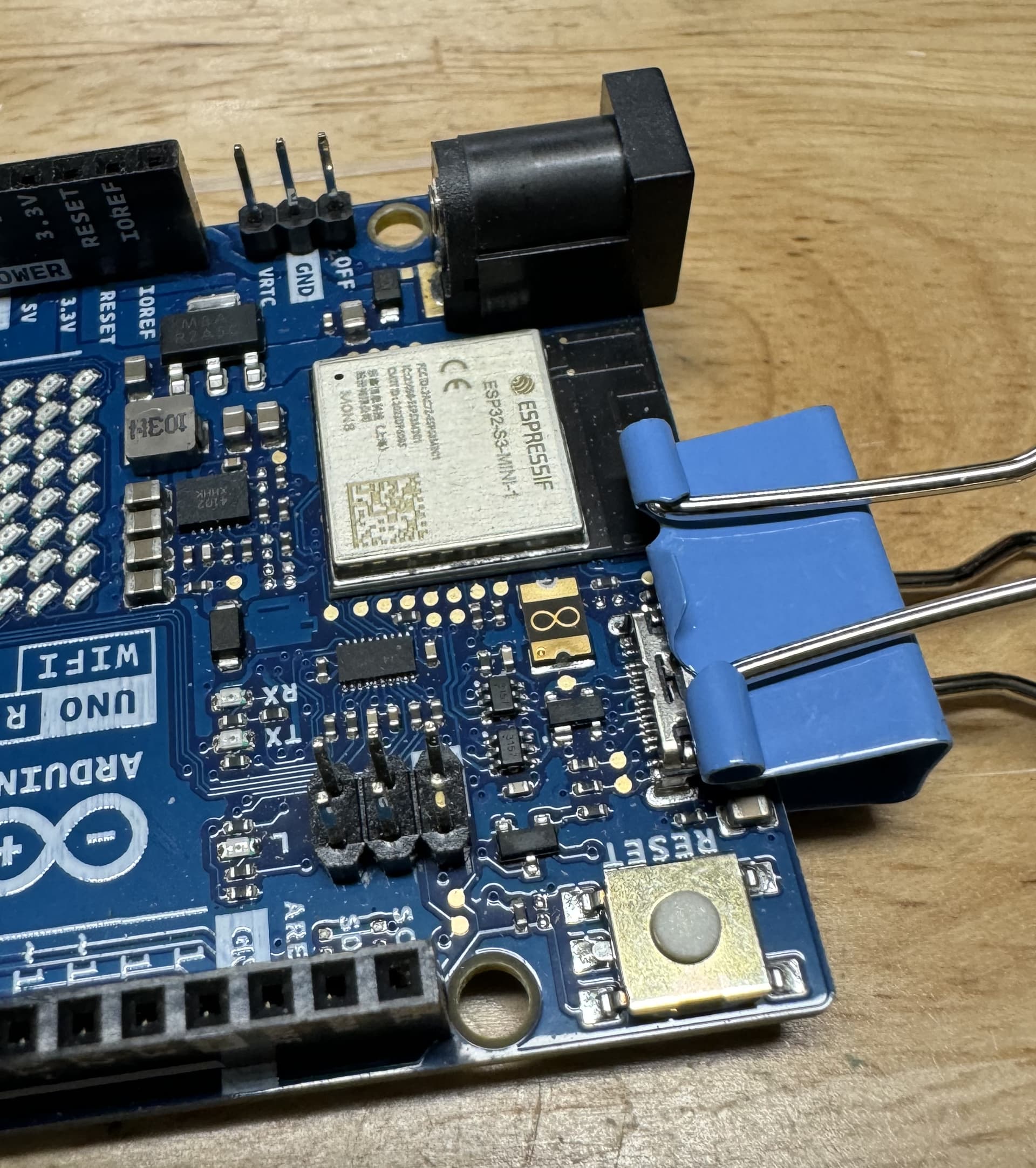

I wanted to add information to this post because I found and resolved the true cause of the No Device Found error. For a while, things looked okay after I switched to IDE 2, but then the errors started again and got worse.
The real problem was the USB-C connector on the R4 was intermittent. Eventually it ripped off when I dropped it while connected and though that would be the end of it. Fortunately, I was able to position it correctly, hold it in place with a metal clip and run it thru my SMD oven. That fixed it.
Originally, the connector bottom was not flush with the PCB, after reheating it with the clip, it is flush, and I have not had a single disconnection no matter which IDE I use. and it has now been a couple weeks.
Whoever is responsible for HW quality control might want to have a look at that mfg. process.
Hi, thank you for letting us know of this. We have reported this to the concerned team. If you have more information or additional images related to the soldering part, share them with us. If you have any further queries or if you prefer to have a replacement for this board please do get in touch with us using the contact us form.
No replacement is needed. This board is working perfectly now...
Thanks!
