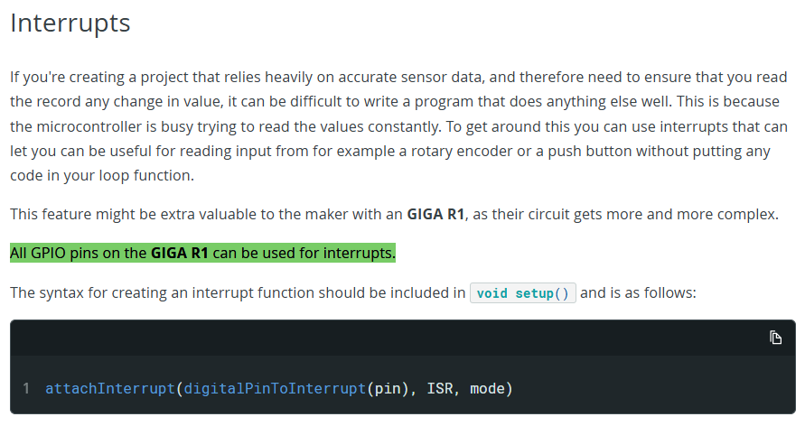

I am thinking about doing a project with a Giga, but the equipment needs to interface with an INTx-pin, and I can't see any in the official documentation for the Giga.
Does anyone know which pins have this functionality?

If you are just looking for the list of the pins that you can use as interrupt input, then if I were you I wouldn't be worried.
From the offical page of the Giga R1, in the Interrupt section, you can find the following:
Thank you. But are they hardware or software interrupts? I was able to find such information for some older cards, but not for the Giga.
