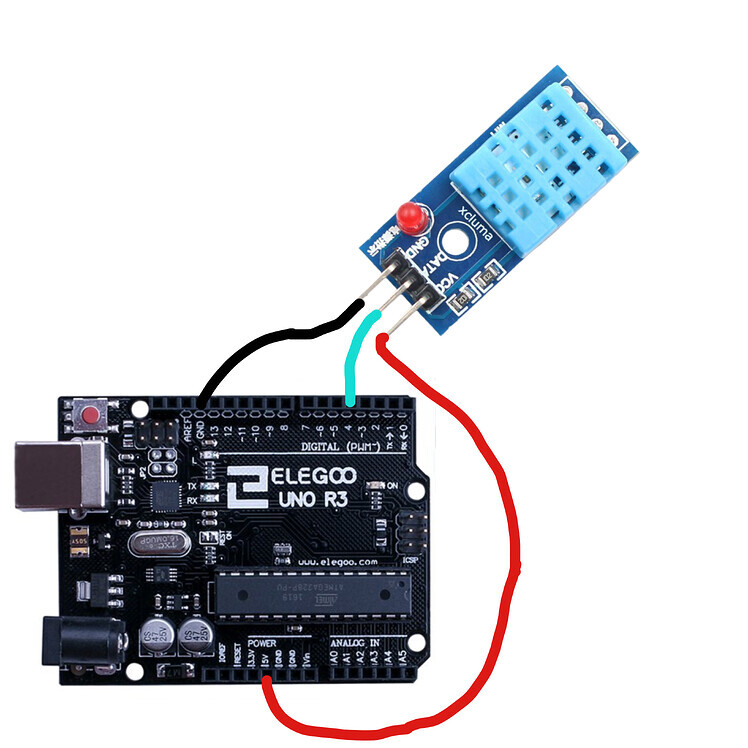

Invalid readings from DHT11 sensor
The red light only means that the sensor module is getting power.
There are a number of libraries for the DHT-11 sensor. The are not alike and code for one may not work with another. Only trust example code from the library that you have installed. Don't install multiple libraries with the same name.
You have not provided much information that we can use to help you. We usually need at least the code that you are having trouble with, a schematic or wiring diagram and technical data (data sheets) for components.
A diagram or schematic that is hand drawn, photographed and posted is fine. Include all pin names/numbers, components, their part numbers and/or values and power supplies.
Please read the how to get the most from the forum post. The post contains information on what we need to know in order to help you.

i tried with this example code and my dht only sends 0 tem and humidity
The code will not compile. It is incomplete. It is missing the #include for a dht library, at least.
Which of the many dht libraries do you have installed? Please provide a link.
How was the library installed? With the IDE library manager or manually?

Check your wiring.

At this point and I believe I saw mention of this earlier, add a 4.7 K Ohm resistor between your Data Out and Vcc. Some sensor boards include the 4.7 K pullup and some don't. Leave your code as is for the DHT 11 change made earlier.
