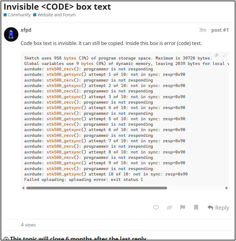

Code box text is invisible. It can still be copied. Inside this box is error (code) text.
Sketch uses 958 bytes (3%) of program storage space. Maximum is 30720 bytes.
Global variables use 9 bytes (0%) of dynamic memory, leaving 2039 bytes for local variables. Maximum is 2048 bytes.
avrdude: stk500_getsync() attempt 1 of 10: not in sync: resp=0x90

avrdude: stk500_getsync() attempt 10 of 10: not in sync: resp=0x90
Failed uploading: uploading error: exit status 1
By the way... the errors in the code box are my IDE not uploading code to any clone Nano (microUSB, miniUSB and USB-C), but the same IDE uploads to ATtiny88 MHETLIVE Micronucleous. CH341 removed and installed. AVR boards removed and installed. Windows 11, IDE 2.3.6. All my boards upload with the AppImage 2.3.6 on Linux Mint 22 (most recent LTS).
[EDIT] The problem was all mine. TOOLS >> PROCESSOR >> 328P (I forgot my Nanos are not old bootloader). Ugh.
