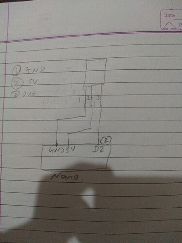

IR receiver won’t work with nano
Hello,
vaibhav here, just getting started. I’m hoping I can get some advice for the annoying problem I’m facing with Arduino nano atmega328p (old bootloader)
Has anyone here managed to get an Arduino nano to work with an IR receiver TSOP 1738? Please share how you went about it.
Objective: To verify that I can get an IR receiver (TSOP1738) connected to the Nano to decode signals from an IR remote.
Problem: The serial monitor on the Arduino IDE does not show any hex codes. I’ve been eliminating possibilities with different tests and am now almost at the end. Would appreciate help on potential fixes.

Possibility 5: Maybe the circuit components or connections are faulty
Test: All connections seem to be wired fine. I’m using the Arduino 5v and Gnd pin to power the IR receiver. Multimeter shows continuity with TSOP 1738 and Arduino nano pin (5v to VCC, GND to GND, AND, D5 pin(5) TO OUT SIGNAL) no output.

You are using the correct connections for the tsop1738? See https://www.batronix.com/pdf/tsop17xx.pdf
You can try connecting a normal led with a 1k resistor between 5v and the OUT pin of the tsop to see if it reacts to IR signals.
Yas i try also the connect are absolutely ok as par it's datasheet

Hi, @squirrel_it
Welcome to the forum.
Please read the post at the start of any forum , entitled "How to use this Forum".
Can you please post your code and circuit diagram?
Thanks.. Tom.. :grinning: :+1: :coffee: :australia:
i try diffrent code with different library's some of them i share here
pin2 to D2

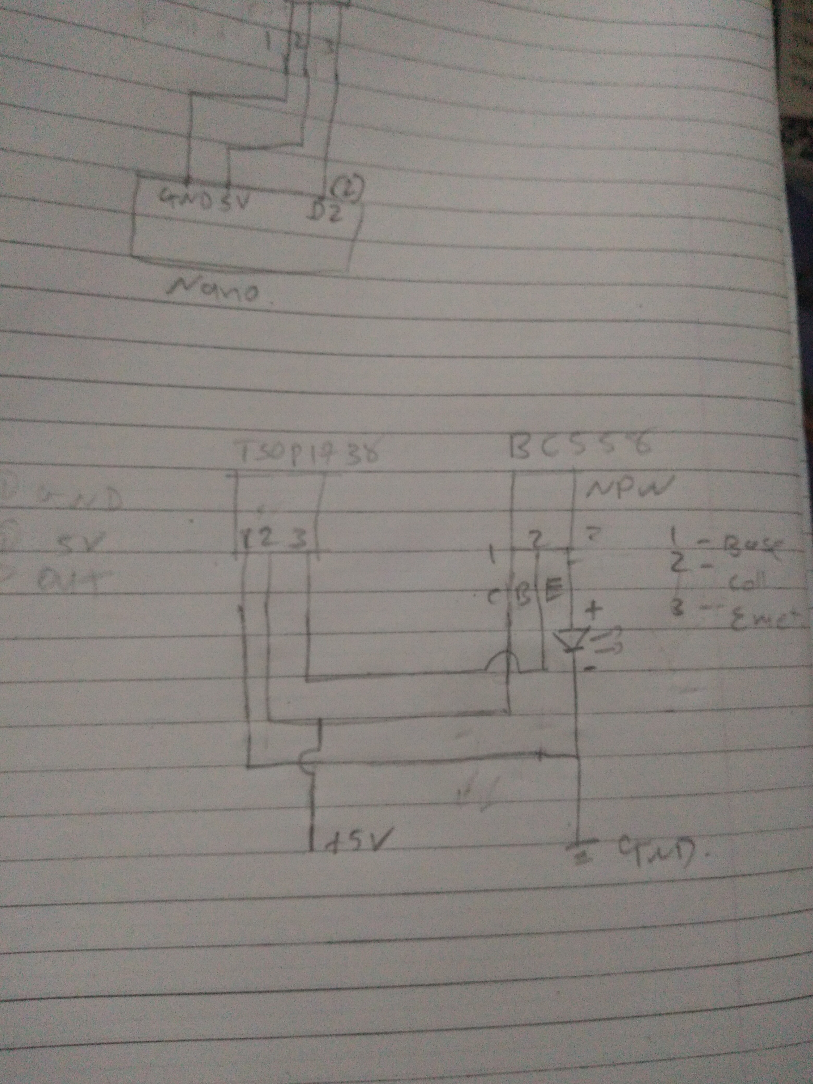

here is diagram
note:-
according code pin are changed also i try changing different pin in code and change in Arduino nano like pin2 to d2,pin3 to d3,pin11 to d11 and so on same for analog pin as par possibility 6 and it's testing in main post.
one more thing i aslo check twice serial monitor for correct com port and baud rate are matching with code so no problem with that also
i'm going to try bc558 npn transistor but i don't have bc558/557 so i'm waiting for package arrive

@6v6gt it's not working today i'm going for CRO test
Either you have a damaged IR receiver, the connections are incorrect, the remote control units you are using are not compatible with the receiver or there is come other error.
Start by replacing the IR receiver . Then get an IR led and series resistor and drive that at 38KHz using the tone() function.

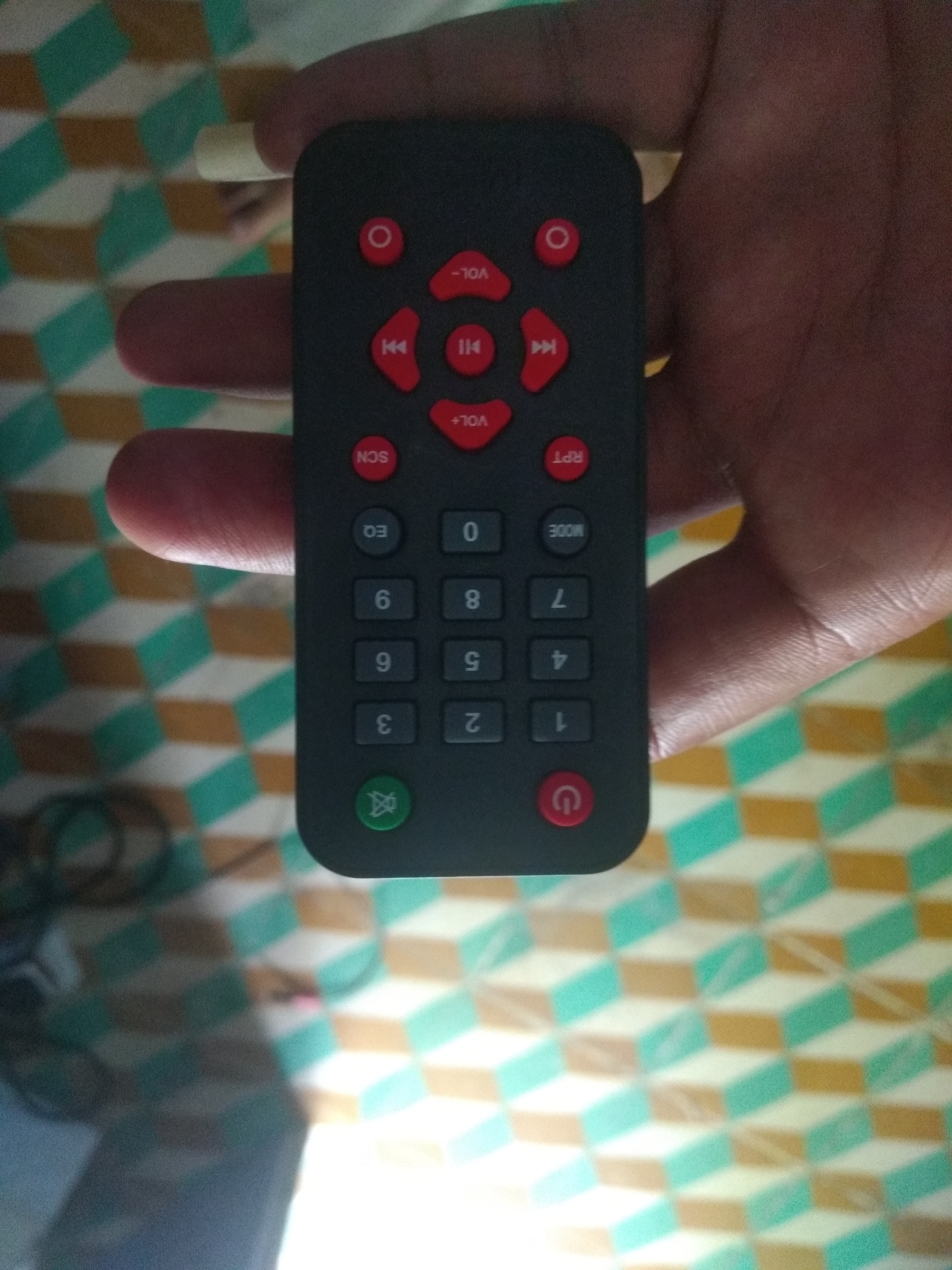

Can you please post some pictures of the IR TRANSMITTER and the IR receiver module?
Do you know if the IR Tx is working?
ok i'll try
that's why i'm going to check on CRO
IR TRANSMITTER
IR receiver tsop-1738
https://www.roboelements.com/product/tsop1738-ir-receiver-arduino-ir-remote-control/
Can you see your Tx working in your phone camera?
Cathode Ray Oscilloscope ?
But have you tried looking at the TX emitter with digital camera to verify that it is Txing?
Yas it's working camera showing blak blinking light but it's not that bright
