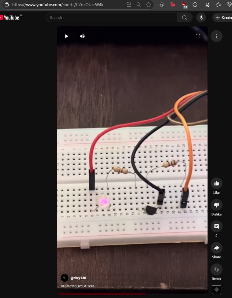

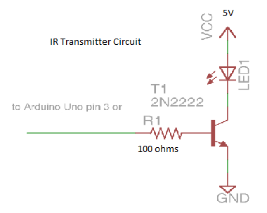

IR Transmitter [Pin 3]: Standard IR LED, 2N2222 Transistor, 100 ohm Resistor https://europe1.discourse-cdn.com/arduino/original/4X/1/9/4/1940fcb591fe5901aa19f3ac81ef0ceaae27294a.png

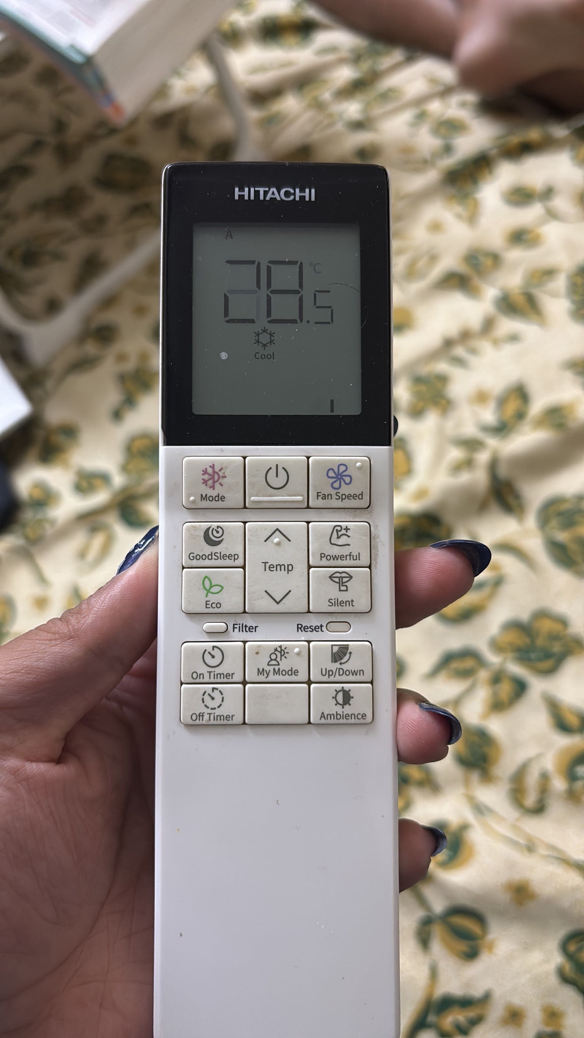

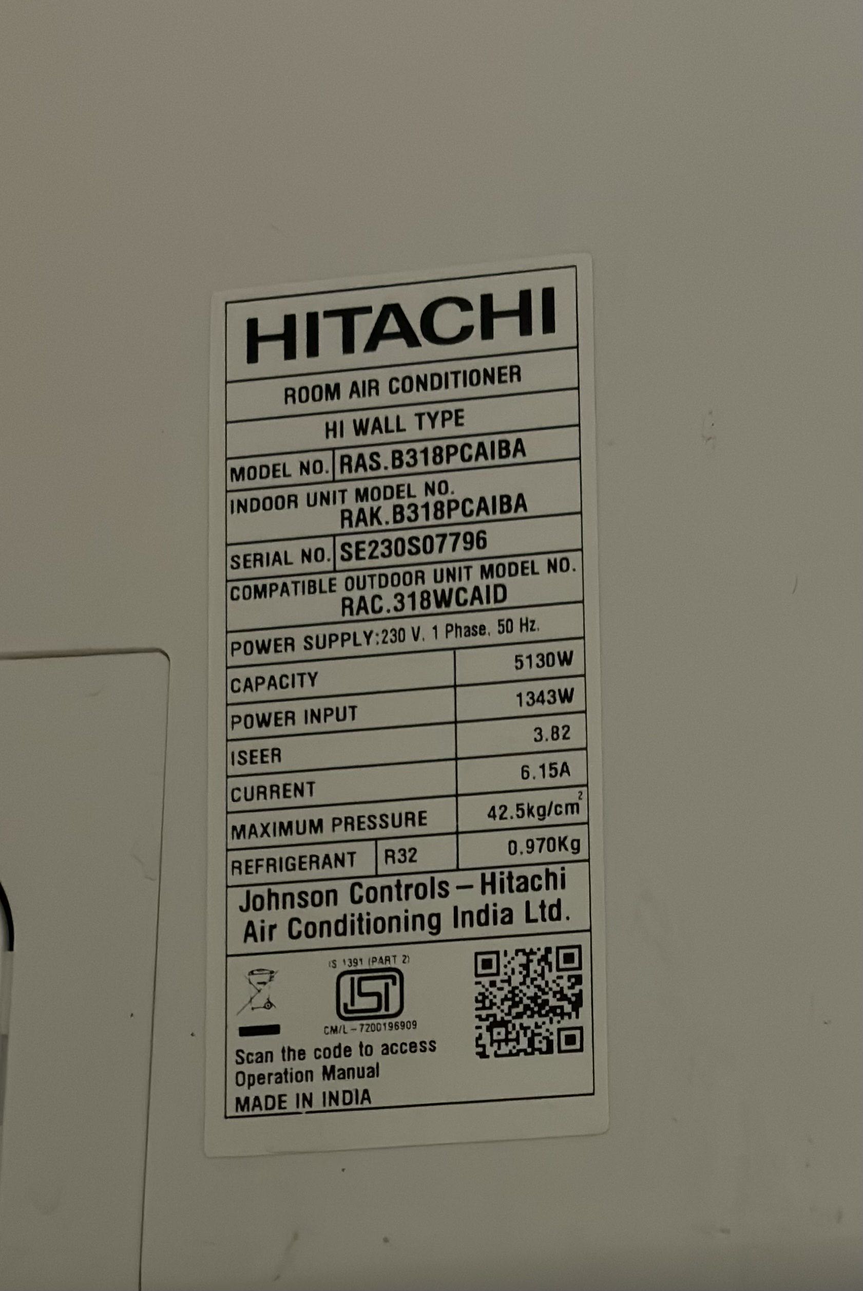

AC Model: Hitachi Split AC (RAS.B318PCAIBA) Attached a picture for reference

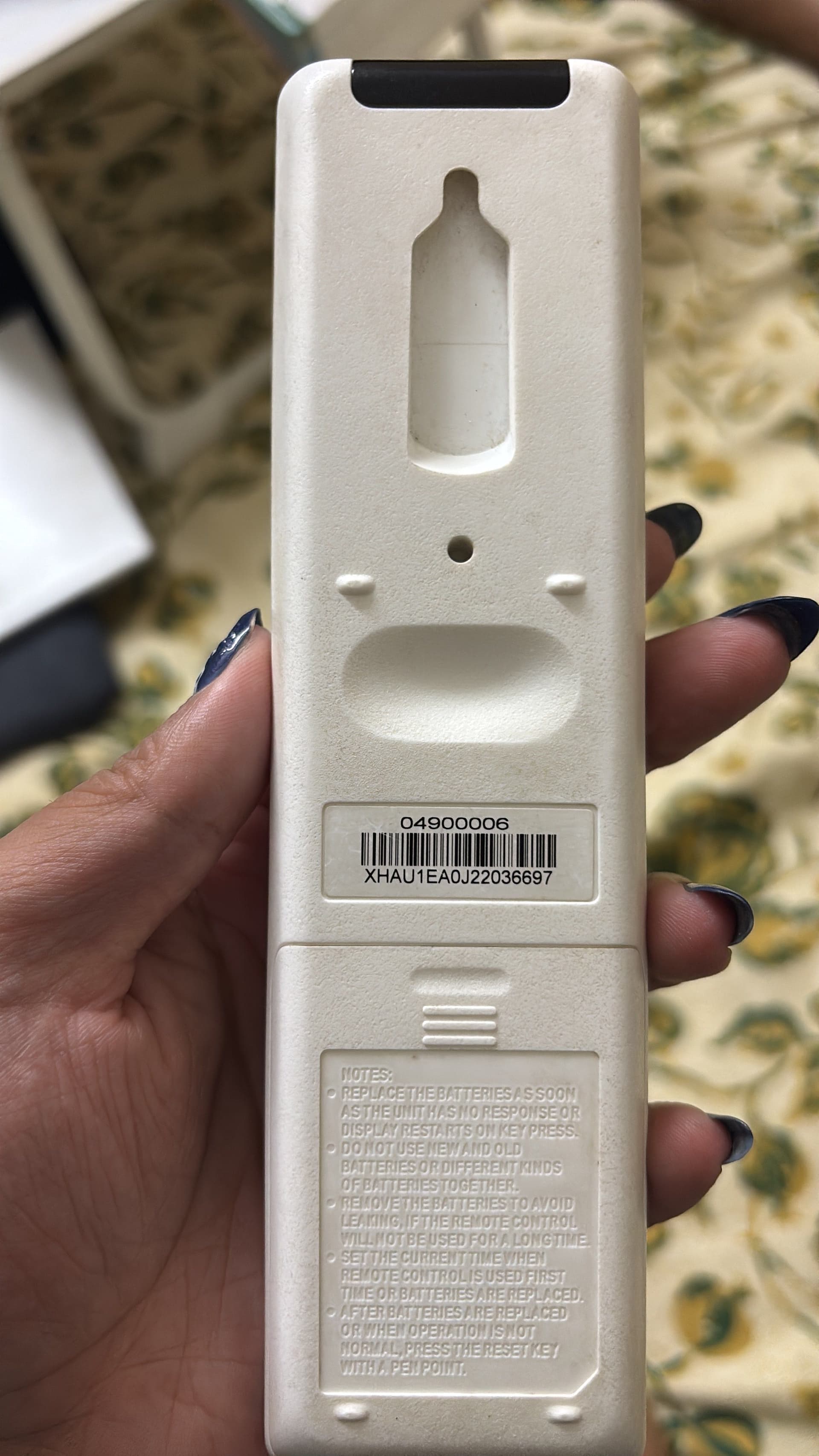

AC Remote: Attached a picture for reference
I was able to capture the raw signal using the Arduino-IRremote-master ReceiveAndSend example.

Your received signal looks valid hitachi 224bit code.
So I expect you have problem on the transmission side.Your link to transmitter circuit doesn't open.

If that's the circuit, you have probably fried transmitter. There's nothing limiting the current through LED. You can test with phone camera if it's working.

Anyway, at this point I would focus on your transmitter hardware. If it really is like you posted, i's basically abusing every component on the circuit and twice arduino/esp. If LED doesn't have resistor in series, it draws undefined current and can get damaged. Also the transistor has max current rating. And if it's powered from arduino, sudden high current draw might cause voltage drop and even reset arduino. On top of that 100R resistor is generally too low to protect the GPIO pin.
If you built it and have components, rebuild it with new components and for example 330R base resistor and 22R in series with IR-LED.

Better not, but since it's correctly built, it should work. If it's a model with transistor it's good. If without, the range is pretty low, test it with short distance.
I'll try both. Here's the circuit video link https://youtube.com/shorts/CZnzOUcrW4k?feature=share
