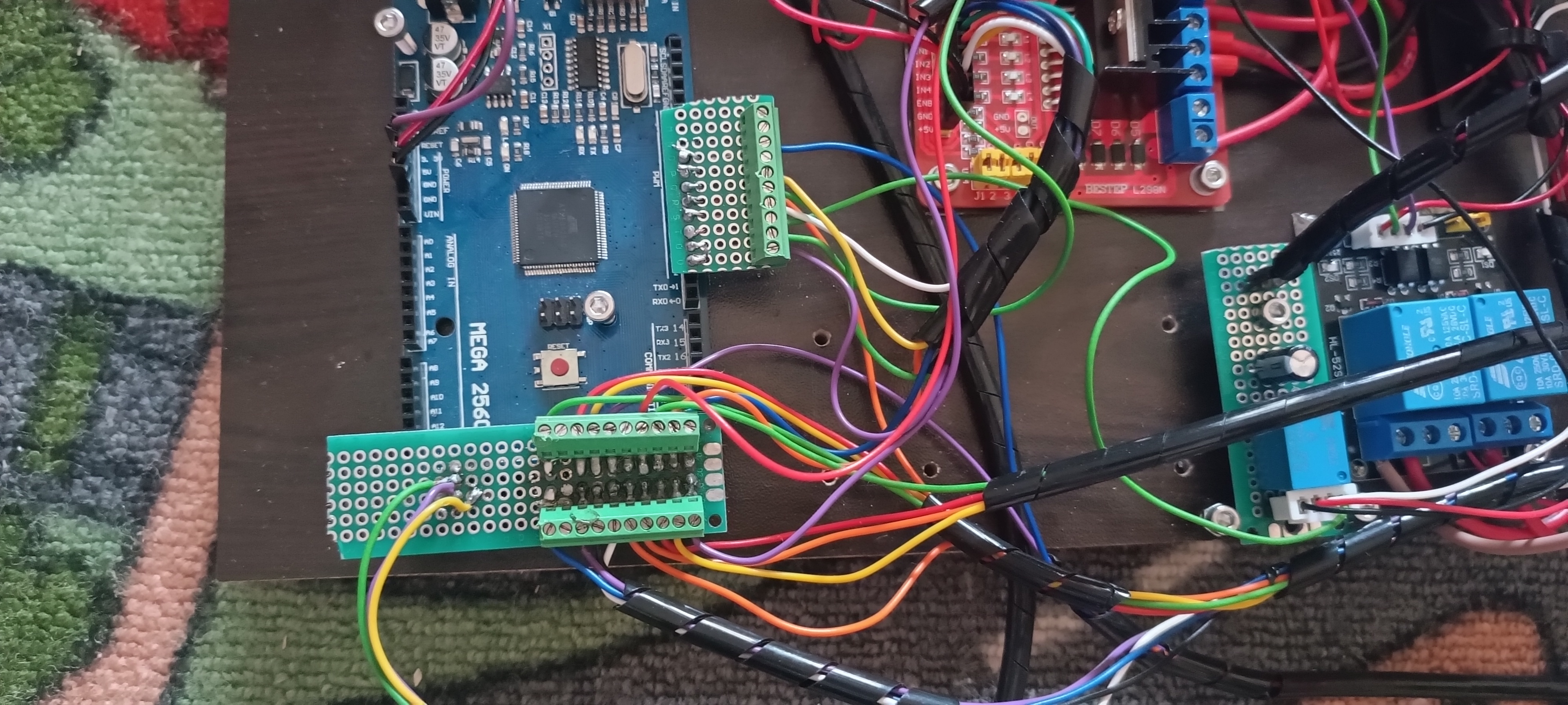

IR sensor signal detected by different pin from the one connected to
I'm using an Arduino Mega for this.

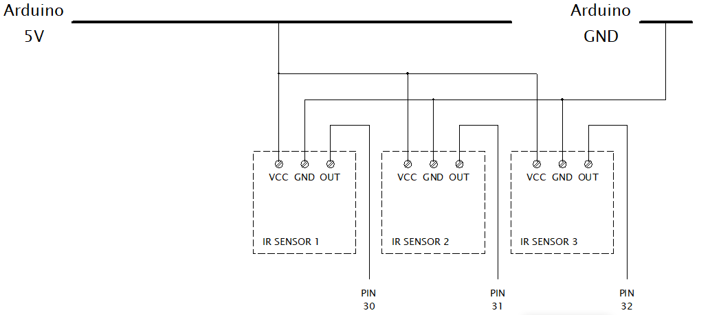

Cable connections are as shown in the picture.
  • When I find something with the left IR sensor even though there is an output the Arduino pin 32 doesn't detect it.
  • When the middle sensor has output the Arduino pin 31 detects it. But the Serial monitor shows that both 31 and 32 have detected something. Playing with the left IR sensor still does nothing. Both are controlled by the middle one.
  • Right IR sensor is unaffected by them.
Instead of a breadboard I'm actually using a perforated board. The first thing I did was freshen the connections on it but nothing got fixed.
Using a multimeter I found no errors in the connections. No shorts.

Welcome! I would expect to get what you are apparently getting. Your picture shows an Arduino UNO, not a MEGA. Different boards different pins. Also how are you powering this?

The sensors are powered by the Arduino 5v pin.
What are these sensors?
Can you post a datasheet or a link here please

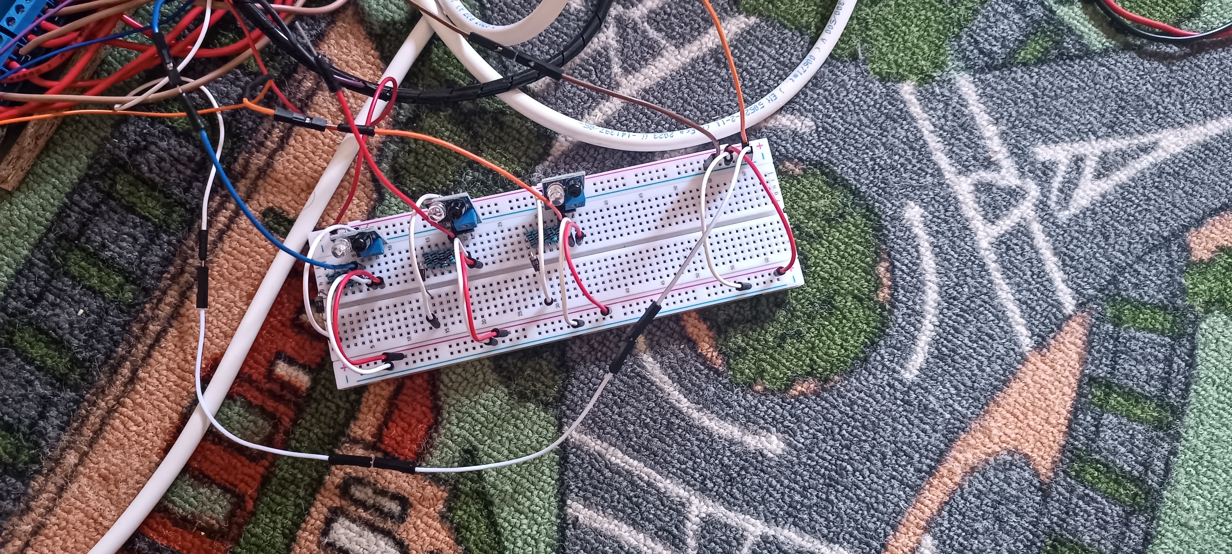

I temporarily moved the sensors to a breadboard for troubleshooting.
Can you please post some images of your project?
So we can see you component layout.
These sensors are part of a bigger project. At the moment everything else is turned off and only the sensors are being powered by the Arduino 5v pin.
Imgur
Imgur
Imgur

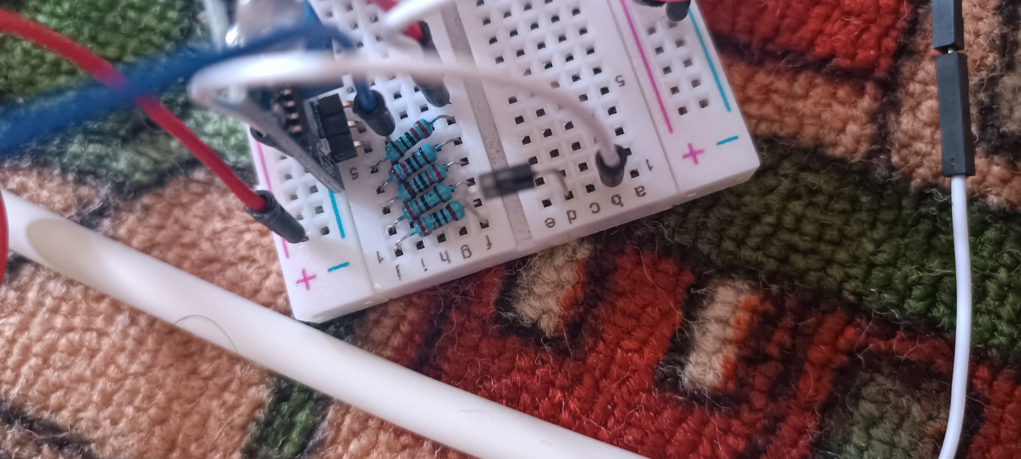

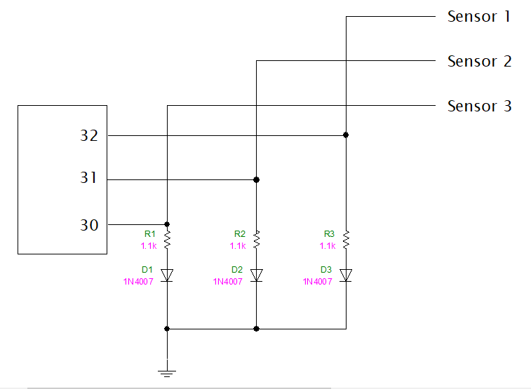

What are all those series resistors for with the diode?

Except you have the sensors on different pins, are using a Mega not the UNO and the sensors in your picture are totally different to the ones you are actually using.
Misleading at best. You've wasted time, ours and your own.
Where did you get the idea to add the resistor and diode to the output of the sensor? If you dreamt that up yourself, stop dreaming.
a7
Your incomplete and misleading answers make it difficult to solve. Start from ground zero, new sensor(s) and Arduino. Remove the diodes and resistors, no idea what they are there for. Post links to technical information on each of the hardware devices. Good Luck!
Hey, I finally found the issue to be with the screw terminals that used to connect the cables to the Arduino and I'm not sure why. As soon as I removed them everything worked as expected.
I just want to apologize for the bad communication and say thank you to all of you for trying help, I really appreciate it!
