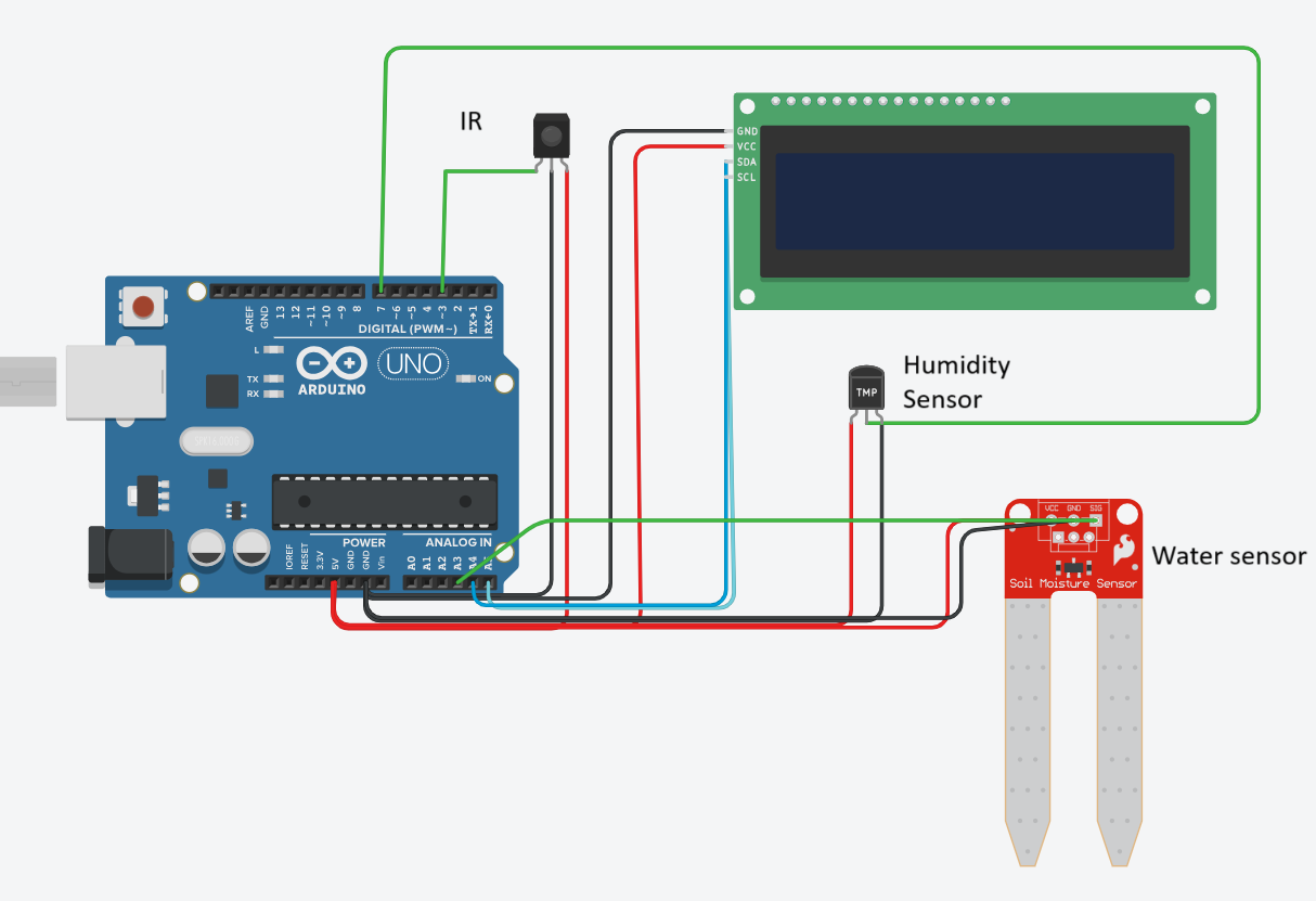

IR showing random HEX values
I have a project that detects the water level + temperature + humidity, Whenever something goes too low, high, or very high, the buzzer will turn on, if I click a button on the IR the buzzer will turn off, but the problem is that when I click before the buzzer is turned on it shows the correct HEX value, but when the buzzer is turned on and I click the button it shows some random values each time.

Most likely there is a conflict with the timer when using IR and tone(). See if another timer can be set on either function.
What type of "buzzer" if an old electro mechanical type then the issue is likely generated electrical noise from the buzzer.
Replace the buzzer with a resistor and LED. If it works OK then the buzzer is the issue.
I've purchased a few boards from ebay that have 4 led's with their respective resistors. I've found them great for testing as their pins go directly into a solderless breadboard.
I also purchase a similar board with 4 buttons on it. Again great for testing.
You read this?
nope but i will
I don't know so much about timers, what I did understand from what you said is that there is a pin with a timer that is interfering with the IR, is that correct, and how do I set it to an other timer?
Well that was the issue, I replaced the buzzer with an LED and it just worked, why then is the buzzer not letting the IR cath the info? And is there any fix to this issue so I can put back my buzz? Would the passive type work?
I just downloaded this and this is just the new IR library, I didn't like this version cause I didn't know how to use it, so I switched to an older one
Buzzers create a lot of electrical noise. Noise like high voltage (10s of volts) spikes on the lines feeding it. If you make a sketch of your wiring I can make suggestions.
After more inspection the problem isn't from the buzzer, I've changed the code In a lot of different ways

what app or website do i use to do the schematic?
TinyCad is a small program that just draws schematics. Pretty simple to learn.
Kicad is a larger program that you can draw schematics and design PC Boards. Pretty intuitive but more difficult than TinyCad.
There are websites that allow you to draw schematics but you are then tied to their website. I know they exist but I don't use them.
I hate to say it but I barley know how to draw schematics, I could do it but I will 100% get it wrong.
Well, now is the time to learn. Start by drawing blocks representing each part and connect them together with the wires you are using.
Good place to start. We've all been there.

I will draw the schematic now and will send it after it is finished.
Thank you all for helping me :heavy_heart_exclamation:
