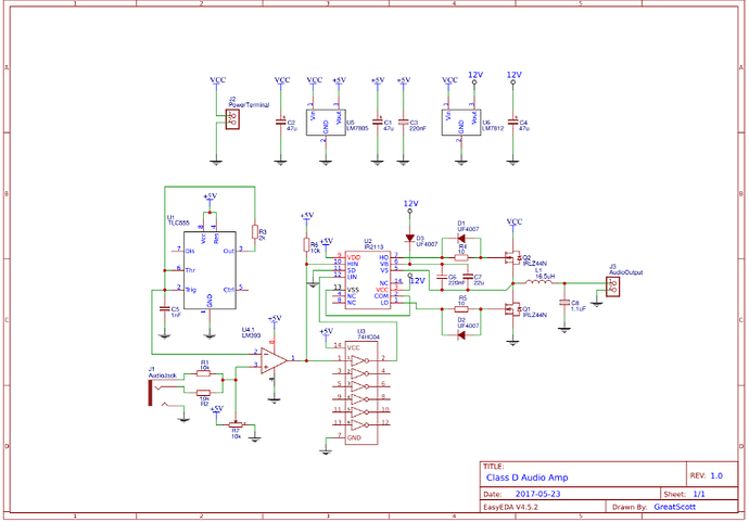

Hi everyone,
I'm working on a Class D audio amplifier project and I accidentally ordered the IR2110 instead of the IR2113, which was used in the original schematic.
I know both are high and low side MOSFET drivers, but I read that the IR2113 has built-in dead-time protection, while the IR2110 does not.
Can I safely use the IR2110 in place of the IR2113 for my Class D amplifier?
Here is the schematic I’m using
Any help, suggestions would be greatly appreciated!
Thanks in advance.
According to the datasheet neither has dead-time protection.
so can i use this instead ir2113?
It seems you also forgot an input capacitor.
Connecting a grounded input source to the input will now change the bias setting of the pot.
Leo..
Looks like you wired the audio jack wrong as well.
The short trace between the two dots should be replaced with an electrolytic cap (~47 uF).
Positive side to the opamp.

Well there are only two differences:
Voffset
2110 500V
2113 600V
Delay matching:
2110 10ns max
2113 20ns max
The voltage is higher, so that is OK, but the delay matching is twice and I don't know if that will make a difference.
Are you sure that amplifier actually works?
