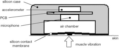

How about building a couple EMG sensors? Perhaps one of those acoustic ones there is a nice instructable on? You know.. to read muscle tension.. tighten a preset group of muscles to activate a function. Like left biceps, right triceps at the same time activates a servo that pops up a miniature "rocket launcher" prop on the wearers arm?

One of the Instructables that you pointed to state that there some consistency problems inherit in manufacturing. >:(
The sensor in the instructable isn't strictly an EMG sensor though, as it uses sound while a true EMG sensor measures electric potensial. The difference, as far as I remember, is that the EMG sensors constantly give you a value representing how tense a muscle is while it's acoustic counterpart only reacts to the minute sounds made when a muscle moves.
I am not sure how an EMG sensor works myself but I think they concist of 3 metal connectors (electrodes) on the skin placed on the muscle you want to monitor. Voltage is applied to the two outer-most electrodes, and the one connected to ground and the center one are connected to a signal amplifier.
