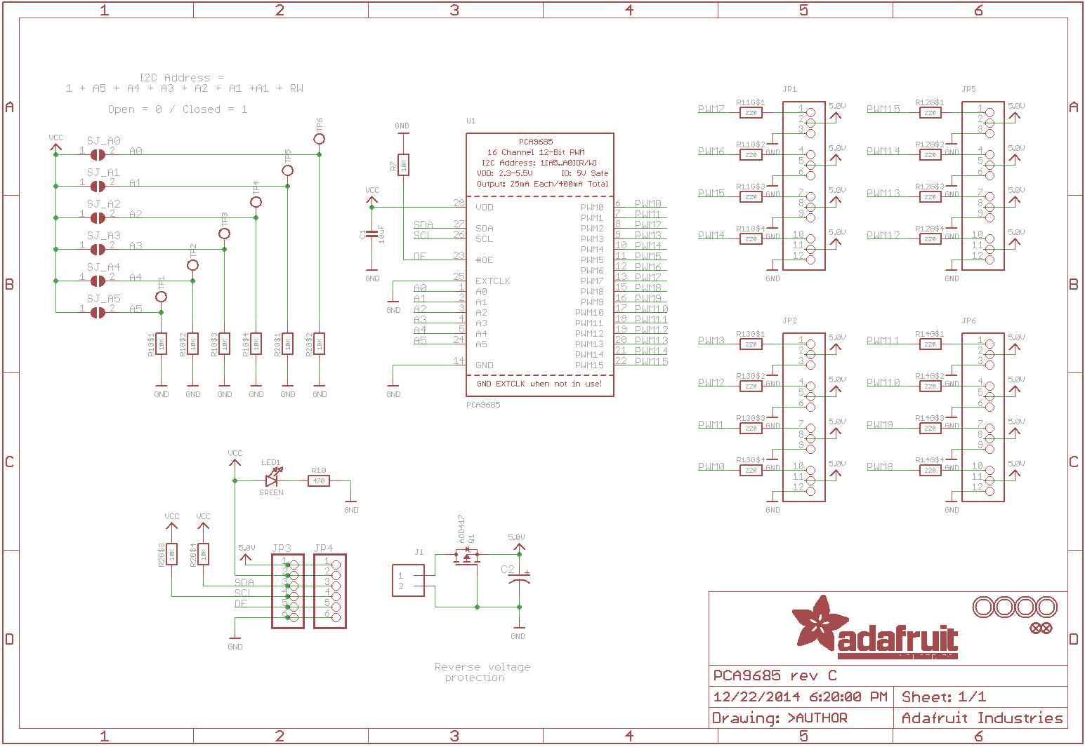

One thing it will depend on what the Vgs(max) rating is for the MOSFET on board. A recent, real Adafruit board will have an AOD417, which has a Vgs(max) rating of +/-20V. So 12V is fine.
Older Adafruit boards used an different (smaller) MOSFET. Clone boards could use anything. Check which MOSFET is on your board and then check its datasheet.
Well Adafruit says it can go to 12V, why would you believe otherwise?
Your question actually has two answers No and No . The IC is rated at Operating power supply voltage range of 2.3 V to 5.5 V, therefore not good at 12V. The Adafruit module will allow you to you can power servos with up to 6V on the V+ line. Therefore again NO to 12V. I cannot find a higher voltage rating for you, sorry.
The screw terminal (and V+) is only connected to the power rail of the servos.
It has nothing to do (has no connection to) the PCA9685.
Doesn't matter what voltage you connect to the screw terminal.
The only limitation could be the ideal diode (mosfet) on the board, if your board has one. Some do, some don't. Then the limit could be 20volt.
The PCA9685 itself is powered via the VCC connector with 3.3volt or 5volt, depending on the logic level of the Arduino used.
Leo..

12volt on the screw terminal is safe for all versions of a PCA9685 board.
As said, it has nothing to do with the PCA chip.
Only grounds are shared, nothing else.
Look at this diagram.
Bottom/middle. J1 is the screw terminal, connected to the ideal diode (FET), which connects to the 5.0V rail, which only connects to all middle pins of the servo connectors, nothing else. 5.0V is a misnomer. They should have named that rail V+ or "servo power".
Leo..

The VCC pin is just power for the chip itself. If you want to connect servos or LEDs that use the V+ pins, you MUST connect the V+ pin as well. The V+ pin can be as high as 6V even if VCC is 3.3V (the chip is 5V safe). We suggest connecting power through the blue terminal block since it is polarity protected.
The schematic on page 27 shows the circuit.
Since they designed it, sell it, and warrant it I will go with what they stated.
Serious inspection of that posted schematic would reveal that the screw terminal + only feeds the + of the servo connections. The chip is powered from the VCC connection, which should be 5V, or possibly 3.3V.

V+ This is an optional power pin that will supply distributed power to the servos. If you are not using for servos you can leave disconnected. It is not used at all by the chip. You can also inject power from the 2-pin terminal block at the top of the board. You should provide 5-6VDC if you are using servos. If you have
to, you can go higher to 12VDC, but if you mess up and connect VCC to V+ you could damage your board!

This is a misleading statement made by Adafruit.
6volt is indeed a maximum voltage for small hobby servos, but it's in no way the maximum voltage for that board.
As stated before, the fet is the only part in that circuit, with a max gate/source voltage of 20volt.
I would say: stay below about 16volt and you should be fine.
Leo..
