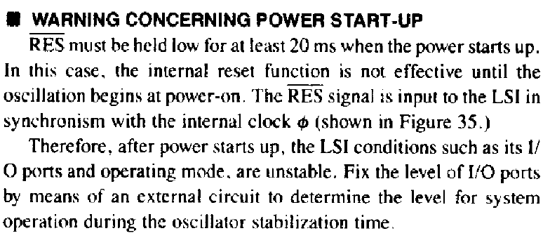

I haven't looked at the 6809 aspect of that, I only have time for the 6303 now. I spent some time digging deeper, and there is a warning paragraph in the HD6303Y data sheet about that.
Basically it says, for that processor at least, the bus and control lines are in an indeterminate state during the required 20ms reset after power up (to allow the oscillator to stabilize). It advises you to provide protection logic for anything that has to be in a known state during that time. Luckily, I have one spare gate input on the single glue chip, that I can use to gate RAM CS* with RESET*:
This circuit can't work with the 6809, as is, because it depends on a WR* from the processor, the 6303Y is unique in having one. Normally you need to combine E and R/W* to obtain it. That would be easy, but would require an additional gate.
