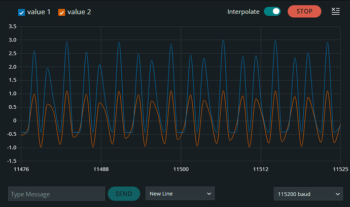

A project I'm doing for school involves using an Arduino UNO, an OLED, and a CT and PT to create an energy meter but the issue is, is that the current and voltage input readings are out of phase and I am unable to reach my desired wattage for the load I've connected it to. Attached below is the voltage and current waveforms with voltage and current being blue and red respectively.
I wish to know if it is possible to phase shift the Current readings to be able to make it in-phase with voltage without adding additional components?
I had the idea that perhaps I could be able to phase shift the current by delaying its analog readings by a certain amount but so far I've no luck.

In your code you are already "shifting" with
It was my attempt but when observing the serial plotter, it took a long time to see a plot of the waveforms and wondered if I was approaching the problem the wrong way
If you are measuring 50Hz AC then try delaying by 490.
Im measuring for 60 Hz AC but I've tried inputting 490, and theyre in-phase! but the readings are inconsistent

If your phase shift needs to be 180degres, then swap the coil connections on the current transformer.
What is the time difference between a positive going voltage zero crossing and a positive going current zero crossing (in microseconds)?

You are going about this the wrong way.
You are taking a single reading of the voltage/current at some random point in the 60Hz mains cycle, and expecting that single reading to be "representative" of the 60Hz waveform.
What you need to do is take multiple readings in quick succession throughout at least one whole mains cycle, and from those readings calculate the rms value of the voltage/current.

FYI: 25ms at 60Hz = 1.5 cycles. So it's a 360 + 180 degree phase shift.
