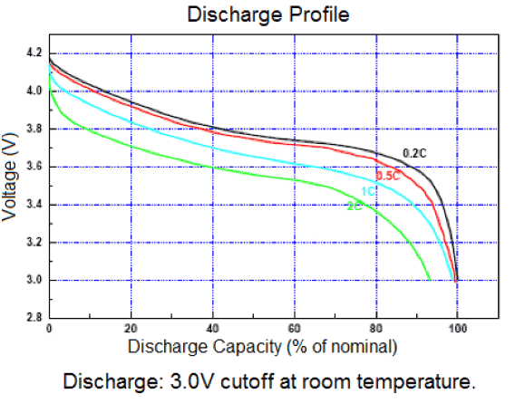

they seem to be LiPo AA so the max voltage will go all the way between 4.0 and 4.2V and will decrease slowly then fall off quickly when you discharge them (see this Adafruit tutorial)
components_tenergydischarge
if they are in series you'll get double this voltage out, if they are in parallel you'll see this voltage and you'll get double capacity.

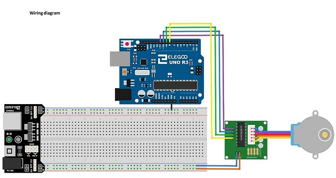

I have managed to find an elegoo breadboard power supply module and my circuit now looks like this:
In the instrctional pdf of the elgoo kit, they are powering both the arduino via USB and the power supply module, so I now have 2 questions:
  • Is there a way of also powering the arduino from the breadboard to eliminate the need for 2 power connections?
  • What kind of power adapter sohuld I get for the power supply module? I only have one of those that connect to a 9v battery but I am not sure how long that would last
If you are powering the Arduino from USB, then you can probably get away with powering the motor from the Arduino's 5V pin. The Arduino bypasses the on-board 5V regulator when it's powered from the USB port.
If you are powering the Arduino from a DC source like a battery, then you can NOT draw that much current from the Arduino's 5V pin. The regulator on the Arduino can't handle the load. With a battery, connect the battery positive to the Vin on the Arduino, and to a separate 5V regulator that can power the stepper.
I do NOT recommend using a 9V battery to power an Arduino. They are designed for low current applications. Just the Arduino itself is about all a 9V battery can handle, and it won't last all that long.
