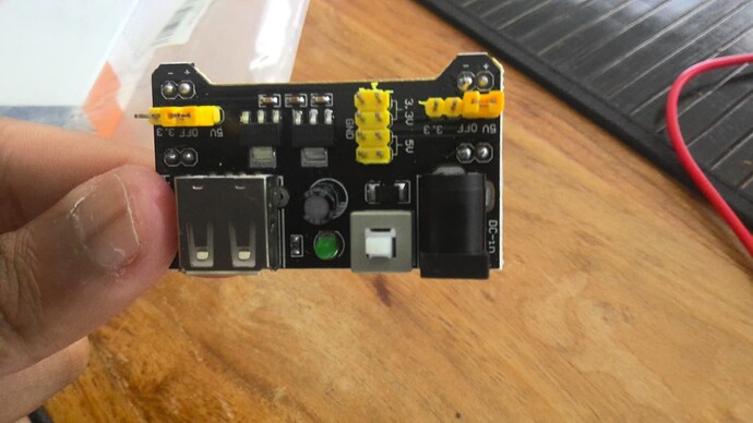

the motor worked fine at 5v but then stopped working after now im using new components and it still wont work well. I put 12v into the power module i have got then it makes it 5v and then the motor used to work fine but now im trying to get it to work again.

if it is necessary to solder than can anyone send a link to a small compact power supply. since i only have a driver, wires, arduino and a power supply compatable with breadboard shown below. I connect this to a 12v plug.
this is my motor
That module is useless for motor control of any kind !
The regulator will blow as it is not rated for many amps.
Am surprised it still works.
You probably burned out the A4988.

do you know any small and compact power modules that can handle the current. Couldnt find any.

yes. do you know any good compact power modules since i need one better than the one i sent
i dont know any small modules that could handle the current needed for my motor

I use these types of supply on my CNC's
Get one that has plenty of amps.
Normally I would get the 10 amps or higher depending on the project.
