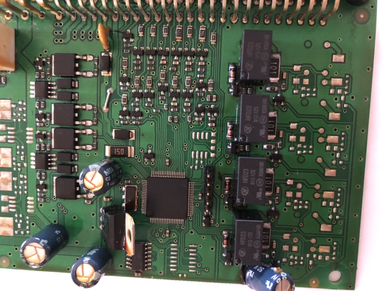

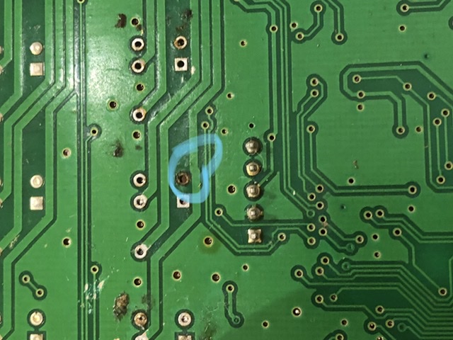

İ was trying to remove a broken relay leg but the ring has fallen.
Is that a problem????

Welcome aboard. I am not sure what you are indicating by a ring, I will assume it is the plate through for the hole the relay was mounted in. If I am correct that is a problem, you relay appears to have that pin connected on the top side of the PCB. If there is no trace to it you will be ok.

I was a dressing the little metal that appears ok on the other slot.
I did not clean the dirt there so that may be causing problem?
show the picture of another side
Yes,if the ‘pad’ is connected on the other side of the board.. you have a problem.

Happily that spot has no connection so it is ok.

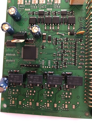

Hi
Can we decide whether marked pin is connected to the trace?
Both sides marked.

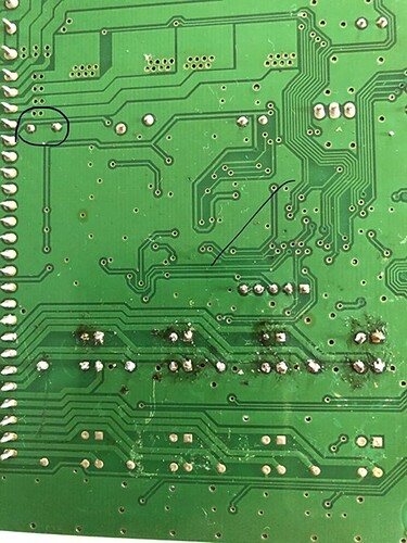

Other side..

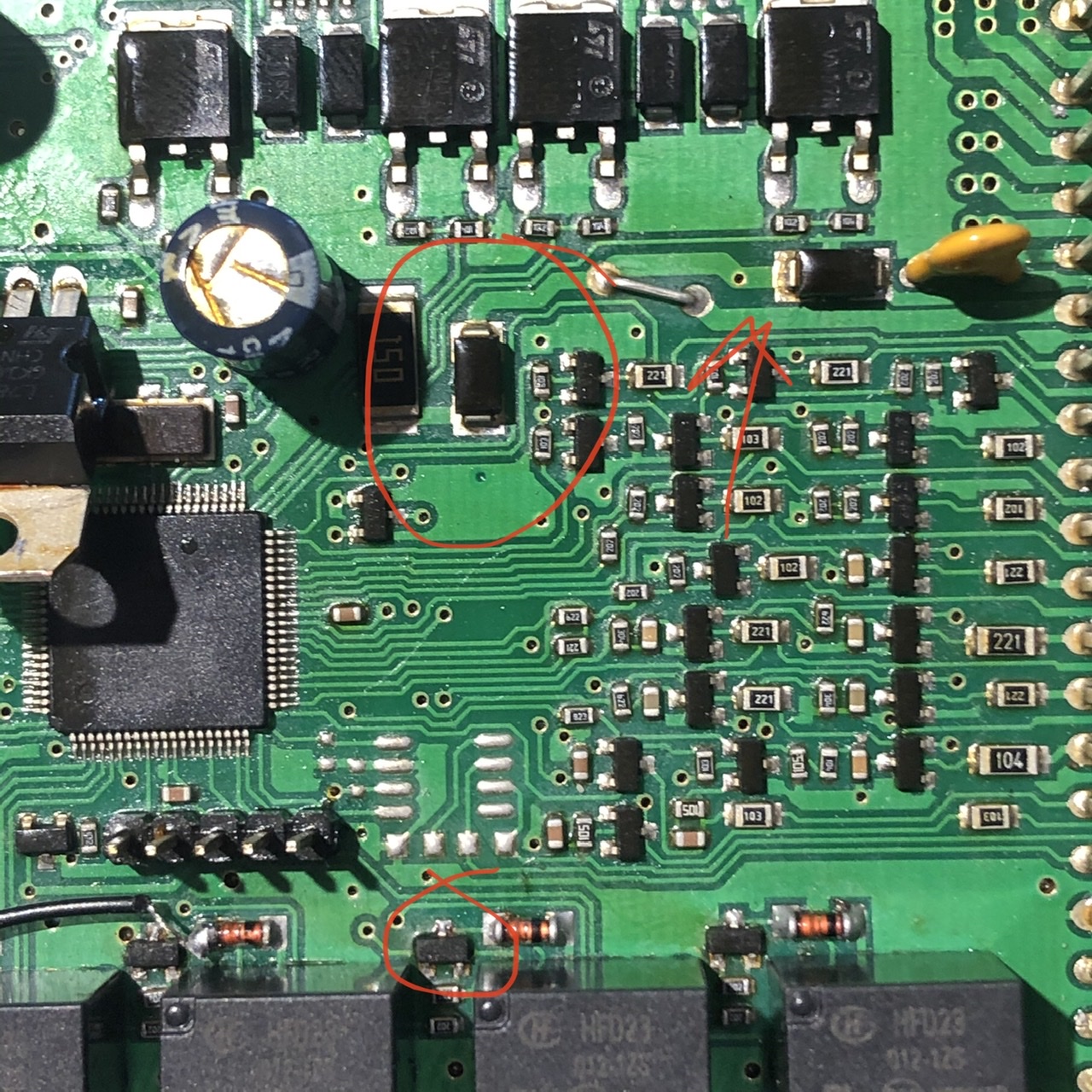

Well it looks kinda obvsly like that’s where the capacitor achieves its connection to the other circuitry; manufacturers typically don’t put components on boards that are not. Connected.
You may see it different. The picture becomes a bit fuzzy zooming in, I’ve had some success taking pictures with a jeweler’s loupe held up to help my phone camera see dets.

are we sure it's only top and bottom layers? no third layer in sandwich?
On the components side one trace ends at one leg of the component. On the bottom the other is connected to ground (?) plane.
EDIT: the trace on the top layer seems to end before the device. In fact it looks more like some infill than a trace.
Can u please identify the marked components?
Circled little component has contact BTW upper and lower left leg so it's busted.
The leg shown with arrow of the other component looks burnt and it also has contact where as the other one has not. So they are two defect components I found...
It looks like a diode.
