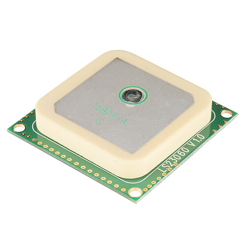

ok thanks for answer lets say i have this device attached in arduino
and this modem attached
its so hard to control the signal strength with 2 items above, in fact that devices is crucial
if some hacker want to stole my device with jammer, they will do it easily, with only jammer they can steal my device. with only jammer.

Its impossible to completely prevent hacking, all you can do is take some measures that make it more difficult.
i.e If the US NSA decide they want to "hack" into your device, they will be able to do it, without you even knowing it happened.
Take a look at this article on Wikipedia Stingray phone tracker - Wikipedia
Albeit that device is supposed to be used by law authorities in the USA... If someone makes it commercially, it can be bought or stolen and used in other countries.
