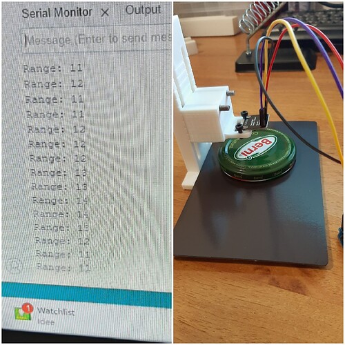

Is VL53L0x Sensor the right choose for my project?
See post #6

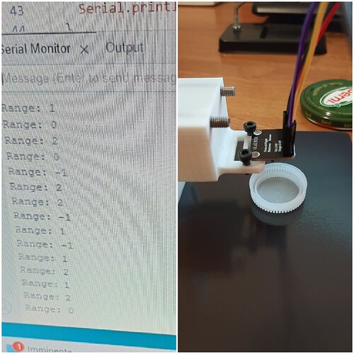

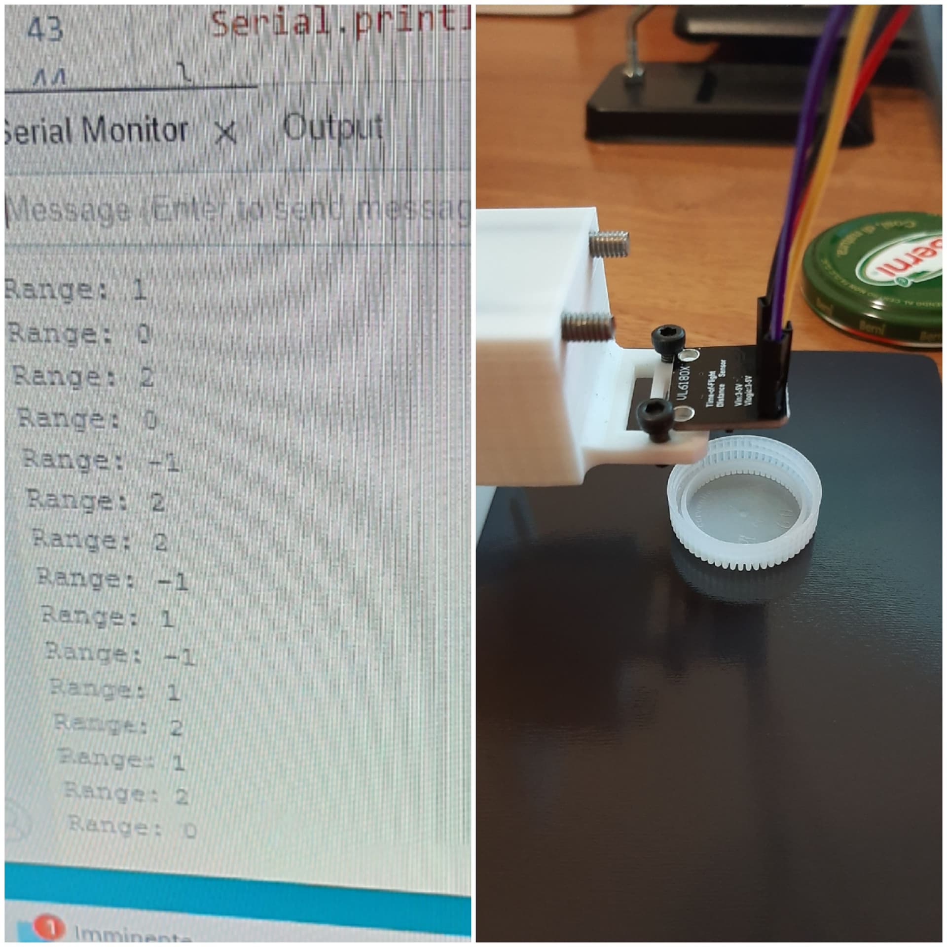

I tried the VL6180x sensor and the results were amazing.
I used the Adafruit library and the example code without any modification so the measurements can be improved via software.
The caps were putted on a black plane to avoid reflections. These were the results:
Thank you all for your help.
