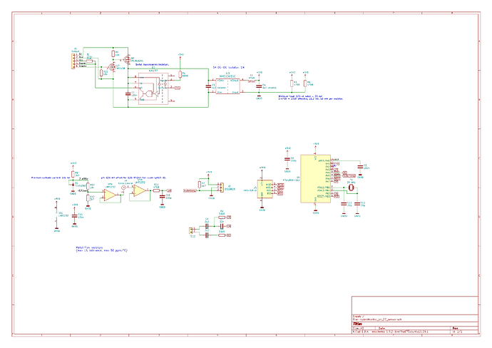

Hello,
I'm trying to get stable pH readings for my aquarium computer project, but my pH readings goes all over the place.
I'm pretty sure this is because of ground loops, because I have a stable pH when I measure the same water in a cup, or when i have my Arduino powered by a 9V battery.
So now I want to build a isolated circuit with a DC/DC converter chip (Murata NME0505SC) and an 6N137 optocoupler for my pH meter, following this self made schematic:
Because I'm still new to all of this, I'm hoping that someone can tell me if this will/ might work.
  • update: I forgot one gnd line, so I fixed that and uploaded a new version of my schematic -
Optocouplers can be used for analog data but it is not easy. Stick with the attitude that optocouplers are for digital data.

Linear analog opto couplers exist, they use two matched photo diodes - you drive them with an opamp feedback circuit to correct for drift.
I agree with @vaj4088 that is is best to resolve the problem with more basic methods if possible. My first thought is the DC-DC converter could introduce another source of noise into the system. And even if you used the isolated Analog - Analog as MarkT mentioned the DC-DC could still cause issues by injecting noise at the sensor.

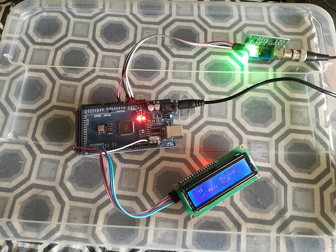

I've attached some photo's of my test setup. Hope that'll make some things more clear.
The issue is that when i have my probe in the aquarium, the pH reading goes all over the place - from pH 4 up to 11. When I measure the same water in a cup, I'm getting a steady reading.
Turning off all my other electrical devices doesn't seem to solve it.

In your schematic there are 3 wires, 0v, +5 and a signal wire from the PH meter to the Mega. In the photos I can see, I think, 4 wires. Please clarify.
Is the PH meter the thing with the bright green LED? It has another cable to its probe I think, that's not shown on the schematic.
What is the 5k and 100 ohm resistor for? That doesn't make sense like that (Although I don't think it's the cause of the problem).
I don't think you have a ground loop problem. I was rather hoping you did, then I would make suggestions. Based on what I can see I don't know what to suggest. Hopefully someone else will know.
You're right. I couldn't find the right ph module part for Fritzing, so I used another one.
My module has a second ground pin, supposedly one for the module and another one for the probe.
The thing with the brigt green LED is indeed my pH module, and yes it does have another cable going to the probe. I don't know how to add that to the schematic...

SOME optocouplers can be used for analog data; the 6N137 is definitely not one of them. It's designed for fast digital transfer; I'm using it in my own isolated pH module to communicate by 9600 bps Serial (the module has an ATtiny on board that does the ADC conversion, then sends the measured pH, EC and temperature data over Serial).
wvmarle:
That sounds very interesting!
Can you tell me more about it, maybe point me in the right direction for making one myself? For instance, what did you use to power your module? Do you have a schematic or photo of your setup?
Using a Murata just like yours for separating power - it's powered off an Arduino (normal 5V supply, doesn't take much).
Not tested this incarnation yet; my previous version had an error unfortunately so not giving you that circuit. I have the PCB of this one mostly built (the SMD parts that is; still have to solder on the connectors, upload the software, and test it out).
Particularly the "enable" part is untested, that is to be able to shut down the device when not in use as it draws some 25-30 mA continuously.
Thinking about your results with the cup on the aquarium. Its likely the pickup is 60Hz from the mains.
Can you tell us more about the PH probe? Where does it get is power and what type of output is provided?
This is the probe and module I'm using:
The probe gets its power from the module, and the module gets it from the arduino...
