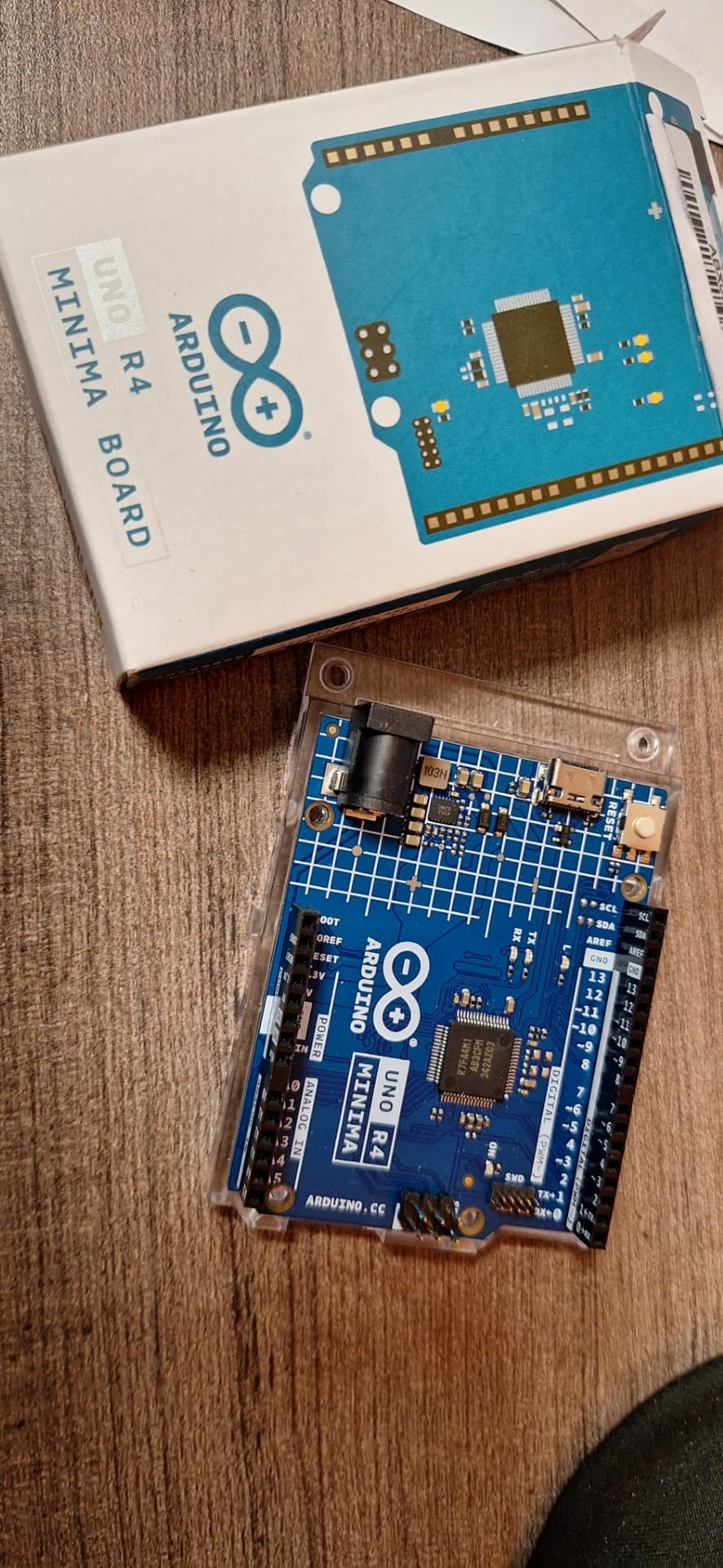

i have make a robot that sud follow a blak line whit to stapper motors and a servo(from rc car) to pull up a hook and 2 light sensors to follow the line and 2 input to set the hook up an down whit the servo
the stapper motors have blod its onwn controller i need for bold the pulse generator to drive the motors and i use the enable input on this controller to run or stop it
evrting alloon workes but when i put it toghter in a program then only the servo works but no motor running.

Hello dtd01
Try and exclude the ussage of the TimerOne.h libary.
see trhe picture i have put on here
i need the pulse to drive (drive speed) the controller need a input pulse and a enable
its a steppenmotor controller
i also bay a arduino R4 minima but the can use the current program
i am not so good in this program wolrd its all new for me
so i need a pulse for the controller this pulse must be always there
whit the enable i set the motor on/off so to stop or drive or turn (one motor of the ohter dive)
i have bay this last week maby i have to change te progam because i get errors wenn i put the progam on the r4
first thank you all for helping
If I understand correctly, the timer and servo do not work together
I need that servo and that timer for a pulse,
how else can I generate a continuous pulse for the arduino uno?
i need one pin out whit a pulse for the motor controllers
Using the enable pin to stop and start isn't really a good idea. Steppers should be accelerated and decelerated to run smoothly. Consider using a library to generate the steps for your motors.
If you use my MobaTools library, you can also control your servos with it, and all is done via timer 1 without disturbing each other. You can also set the speed for servo movement, so you don't need your for loops to do that anymore.
