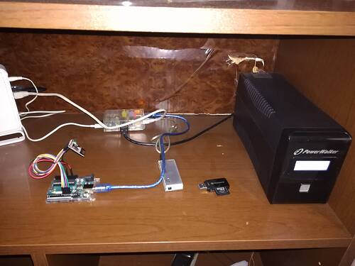

Hi to all,
I have some issues in home power. I live in Italy and base voltage is 220V.
When I use a big load, as washer dinner, washing machine or electric oven, voltage goes from 220/221V to 210V (sigh).
Home is not mine, I live in rent.
PC, Tv and Raspberry are feeded via UPS, that reacts very well to this voltage peak. Arduino is connected and powered via USB from the PI itself, and Arduino has NRF24L01 connected, trasmitting with other (battery) powered Atmega.
The trouble is that sometimes this peaks render the Arduino (original R1) instable, and I need to restart the PI+Arduino itself or wait for the big user ending. :confused:
Is there something that I can do (other than ask to the owner to call his technicians)? I think to know also the issues. The watt meter is distant from the home (about 100 meters) and the cables are not so-big, from meter to the home itself. But it is not my home, cannot act directyle.
Thank you very much!

Can you post a picture of your project so we can see your component layout please?
I know its a lot, but we are in troubleshooting mode. :o
Thanks.. Tom.. :slight_smile:

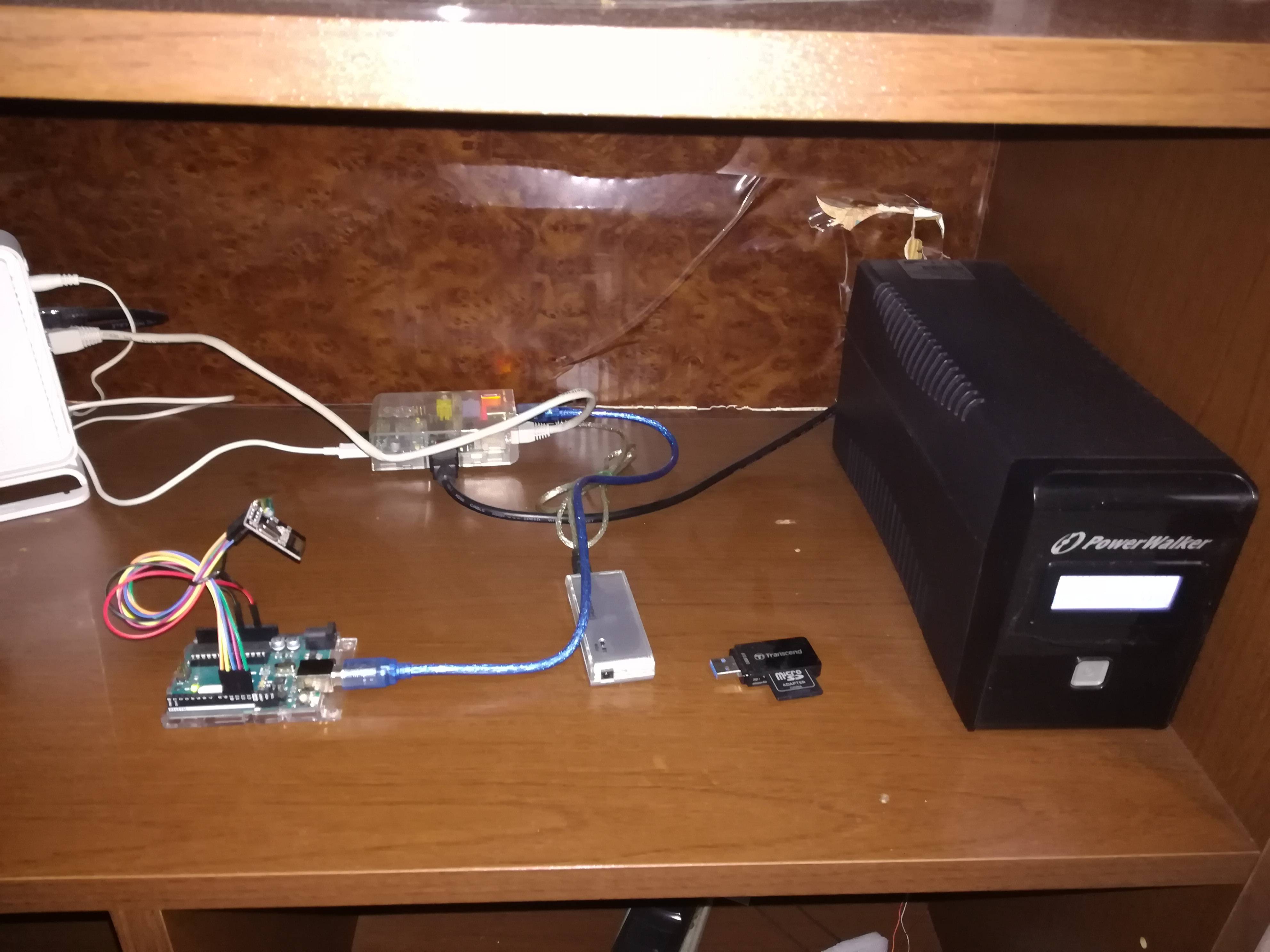

Sure... it's very normal project..... NRF with dupont from UNO. Uno power from USB of PI (I need for serial communication). Power PI from Samsung 5V/2A. Power for Samsung from UPS. Power for UPS from main :slight_smile:
UPS mantain PC (24'' Led HD, I36100, SSD, 3xhd RED WD, gtx750ti) + router + PI/UNO. PC is low consuming.
