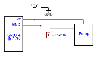

Hi, this is my first time using mosfets and want to use it as a switch to switch a 5v pump from a esp32 super mini c3. I've tried like every combination and the mosfet always gives 5ish volts or nothing except the one time I wired it High Side instead of low side in which it only would output the same voltage input into the gate. This is what my wiring is which I think matches what I found on google but still nothing.

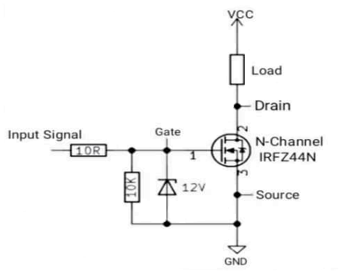

Shouldn’t there be a 10K resistor between gate and GND ?
Something like this

The pump motor will destroy the MOSFET with high voltage spikes, unless you use a kickback diode, as show below (D1).

Thanks for the replies, I fixed it with a 10k resistor between gate and GND, so thank you UKHeliBob, I seem to be able to power the pump fine now and the esp32 works fine, the pump is kinda weak and works from 5-12v at like 100ma and the esp32 is rated to handle up to 6v but in my experience (cranking up the bench power supply till it dies) can handle like 7v. Is the kickback diode necessary? I really don't want to wait for shipping again.
Here is my wiring that works rn:

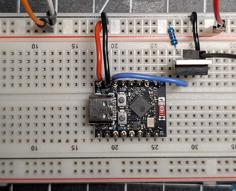

Does this look right? I don't want to fry anything
No. The diode arrow symbol points toward the white band on the diode casing.
The diode should actually be placed across the motor terminals, with the white band closest the positive motor power supply connection.
Keep in mind that breadboards are designed for low power logic circuits, not for motor or servo current levels. The tracks may burn.
