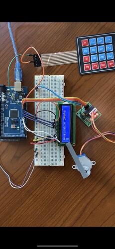

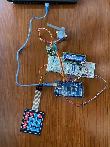

We are engineering students using an Arduino mega2560 that came with the complete starter kit for a class project. We are creating a prototype for an automated parking system using a keypad to act as a pressure plate so that when a button is pressed, our stepper motor will open a gate, and the value on the LCD displaying the number of spots available will go down. We are having an issue with our LCD where it goes completely white after a second of the code running. The counter seems to be working in the serial monitor, but the LCD is not. The LCD works properly when we remove the keypad from the code and displays the proper decreasing values. Any help would be very much appreciated!

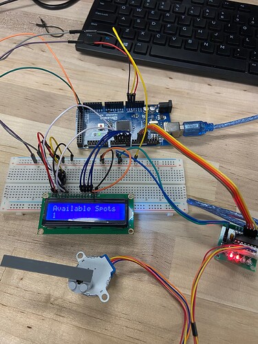

We are also new to using arduino. Here's another picture showing that the LCD does work when the keypad function is commented out of the code and taken out of the 'if' statement in the 'void' loop().

You have a conflict sharing pin 7 in the code.
byte rowPins[ROWS] = {9, 5, 7, 6};
and
LiquidCrystal lcd(2, 3, 4, 5, 6, 7);
As @sterretje said in the previous post.

Also 5 and 6.
... and 2 and 3 and 4.
byte colPins[COLS] = {8, 4, 3, 2 };
We switched our pins in the code and attached them to the digital pins and this worked! Thank you so much we didn’t think that these pins that weren’t even being used by the keypad, as we only had one pin plugged in for the first column and one for the first row for testing, would have this effect in the code to cause this problem.

But they are used by the code which configures all pins of the keypad in a way that is incompaitble with the LCD. You probably can get it to work for two buttons with something like
  const byte ROWS = 1; //four rows
  const byte COLS = 2; //four columns
  const char keys[ROWS][COLS] = {
  {'1','2'},
And the appropriate selection of pins.
Study the library and you have a good chance to find out why they interfere.
