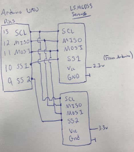

Post a wiring diagram of your setup. Connecting the LSM6DS3 to the UNO directly might fry the chip. Maximum voltage on the SPI bus is 3.7V, the UNO uses 5V level on it's signal pins.
So I'm using a breadboard for my my sensors, and I've connected the power to 3.3V, and when I measured the voltage it came out correct. The pins also register 43.6mA for one, and 42.7mA for the second. Is it possible the current is not high enough? Also I cannot find my correct boards in Fritzing, will pictures suffice?

You don't have to use a program for that, hand drawn is sufficient. If you post sharp pictures where every connection is clearly visible, photos are OK too.
Here is the schematic:

I'm not sure exactly the reason on why the data is corrupted. When both sensors are connected, I I use the serial monitor for feedback and check to see if the CS pins are active and the device has initialized, however it tells me neither are active and the data coming back is garbage. My next step is to no longer use the SparkFun library and implement when the CS pins go high and low myself, along with transferring the data via SPI. It's just that the library obliviously made data collection so much easier.

The last picture shows that the signal levels are at about 3.5V, so there seem to be protecting diodes in the LSM. If you run this setup for a longer time period expect the chips to fail sooner or later.
I still recommend to use level converter.
Interesting are the glitches on the MISO line. I would assume they are to heavy to leave the signal output undisturbed.
Please post a picture of the complete setup, maybe there is another source for interferences.
