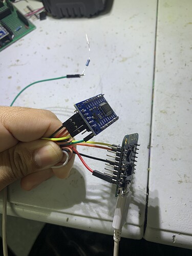

Photo attached, but not much to show. I’ve stripped it down to just the wires running between everything
I still believe the issue is the way you are using the chip, not the chip itself. Whatever issue it is you are persisting with, you are probably persistently damaging each chip you use!

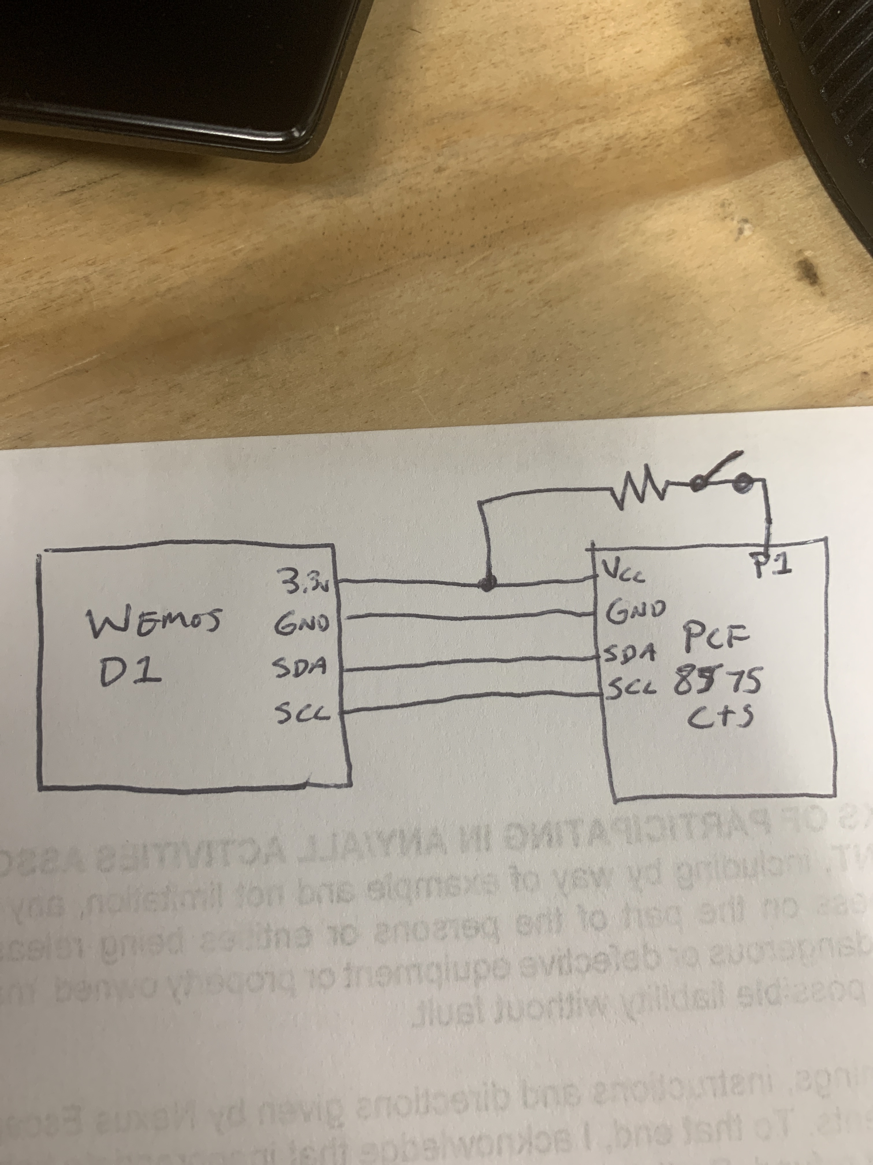

Then post a schematic. Hand drawn is fine as long as it is neat, clear and a proper schematic. And get some breadboards!

Ok, so...
You are in fact powering the pcf with 3.3V.
You are wiring the button between 3.3V and the pcf pin with a 1K series resistor, but you cannot detect the button press?
Connect the button between the pcf pin and ground. Forget the resistor, it's not needed. When the button is pressed, the pin will read LOW.

Can you please post a picture of the component side of your 8575 module?
I believe there maybe another problem. That module has an inbuilt 3.3v regulator judging by the picture the OP provided. Something like this: https://www.ebay.com/itm/PCF8575-IO-Expander-Module-I2C-To-16IO-For-Arduino-/132718867533?_ul=IL
If the solder jumpers are not set correctly, the 3.3 volts from the Wemos D1 will go through that regulator reducing its effective voltage.
Further, the datasheet specifies external pullup resistors of 100k (to the same potential as the pin 24 of the PCF8575)
Ah yes, I recall that now. :confused:
There is a rather strange reason why they are necessary, but I cannot recall it just at present.
