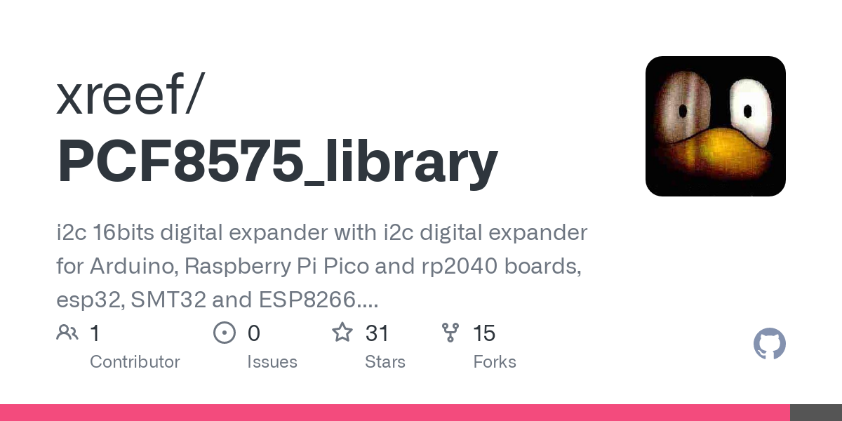

#include "PCF8575.h"
There are several libraries available with this name. Which one are you using? Did you use library manager or download a zip file? From what address?
I think it might be this one?
This library defines these pins:
#define P0   0
#define P1   1
#define P2   2
#define P3   3
#define P4   4
#define P5   5
#define P6   6
#define P7   7
#define P8   8
#define P9   9
#define P10   10
#define P11   11
#define P12   12
#define P13   13
#define P14   14
#define P15   15
So the library author is not following the pin naming convention used in the chip data sheet. That explains why P16 and P17 stop the sketch compiling. It might also explain why your sketch does not work. The pin labelled P10 on the module would need to be P8 in the code, I think.
