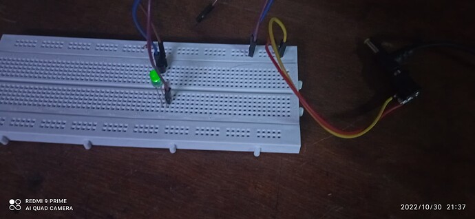

I have a S9013 transistor (PNP).
I wanted to use it as a switch to ON/OFF a LED
But the led should be off but it is partially on and after i give power to base the led turns on fully.

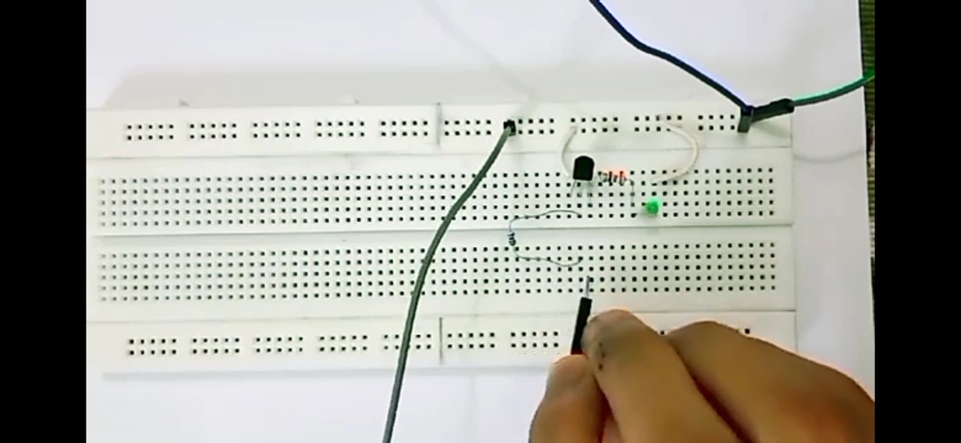

LED when the base pin is not connected:
LED when the base pin is connected:
Connections

You mean NPN.
Only low side switching of 24V is possible. Arduino cannot take the base high (compared to 24V) it can only go up to 5V.
You will damage the arduino if you feed 24V into an output pin.
Low side swiching is done with a NPN transistor (emitter to ground, collector to load.
Edit: this post was written while post #2 was posted. So I assumed that the transistor was pnp type as op stated in post #1
Use circuit D2
  1. As noted before it is NPN
  2. 24 V is close to the absolute maximum of 25 V CE of this transistor, it may be leaking a bit when it should be off.
  3. You have Collector and Emitter swapped?
No the emitter and collector are not swapped, the transistor is swapped but the connections are same
