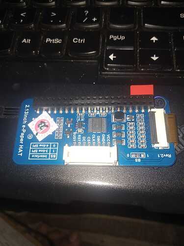

Hello everyone,
I'm having some trouble trying out the GxEPD2 Hello World sample program with my ePaper display. The model I'm using is the Waveshare 2.13 labeled as HINK-E0213A22-A0 SLH19148.
So far, I've tried using GxEPD2_DRIVER_CLASS GxEPD2_213_B72 and GxEPD2_DRIVER_CLASS GxEPD2_213_B73, but the display does not show anything. However, when I tried using a different sample program from EPD epd2in13v2, it successfully displays an image.
Has anyone encountered a similar issue or could possibly provide some guidance on how to troubleshoot this?
Any help would be greatly appreciated. Thanks!

Have you followed @ZinggJM link to the SOLVED page post #6?
yes just like that, i have read the link to the SOLVED. the man has similar problem like me, and im just tryng change the driver class only as i said before and about the pins out im still using waveshare manual
Take a look at GxEPD2_wiring_examples.h
im using arduino uno VCC at 5v
// mapping suggestion for AVR, UNO, NANO etc.
// BUSY -> 7, RST -> 9, DC -> 8, CS-> 10, CLK -> 13, DIN -> 11
thanks for reminder, i was wrong thats the pin out is different with waveshare manual... the different is in RST pin and DC pin.
thank you so much guys, and im sorry for all my mistake.
