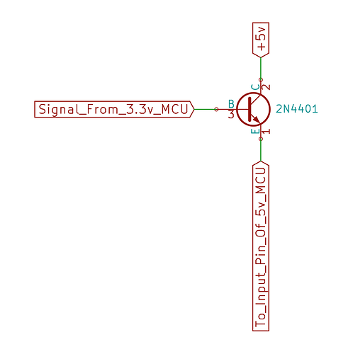

I have a need to control a 5v input with a 3.3v output. I did some research about level shifting, and there are many ways to do it.
I grabbed some random parts that I had laying around and made something work, but I am not sure if it is a good idea to implement in a final product.
Usually an NPN transistor is used to take a load to ground, and I have used one for level shifting when taking the higher voltage to ground using the lower voltage on the base.
What I have done here is basically opposite of that. I have put the NPN upstream of the MCU and I am using it to pull the pin HIGH. My question is whether this is a bad idea to connect the tansistor in the follwing manner:
emitter to a 5v MCU input
base to a 3.3v MCU Outputf
Collecter to +5v
It DOES work, but it might be a bad plan long term. My other method would be to use a PNP and NPN pair, using the NPN to take the PNP base to ground, and the PNP would supply the high signal to the 5v. Is this a better method?
Attached is a drawing of what I have.

Consider what will happen when you put 3.3v on the base...
Effectively instantly, the emitter will be at 3.3v, and it won't get any higher, because the base and emitter are now at the same potential....
That said, I've yet to find a 3.3v-level signal that didn't read correctly on a 5v mcu.

HA! Wow... I knew I was missing something. So I didn't gain anything, and was simply switching it with the 3.3v.
Okay... That was a bit dumb. I guess I need more sleep in my life.
I may just go ahead and use the 3.3v signal and hope for the best. As long as supply voltages are consistent we should be fine.
Can anyone confirm that an NPN PNP pair would work? Could I use the NPN to pull the PNP base to ground, and then let the PNP supply 5v to the MCU?

Yes, this is the standard way to use PNP or P-chan fets (which have the analogous problem) to switch voltages higher than the signal you're switching with.
And yeah - there are level shifter chips that have it all done in one neat little package (they work much the same way).
HA! Wow… I knew I was missing something. So I didn’t gain anything, and was simply switching it with the 3.3v.
In fact you actually lost 0.7V. The output on the emitter will not get any bigger than 3.3 - 0.7 = 2.6V
So if it works off that you could connect it directly.

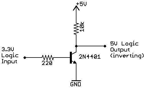

A quick hack:
PS: you may remove the R1, you get the same results :slight_smile:

A quick hack:
Which is similar to this...
...which works great!
Yea, that's a 100y old design :slight_smile:
Mine uses 1 resistor less, provided it is not meant bidirectional.. :slight_smile:
I’d prefer just a simple common-emitter configuration. This circuit inverts the signal, but this could be compensated for in the firmware. If the 5V MCU has pull-up resistors then the 10k could be eliminated.
