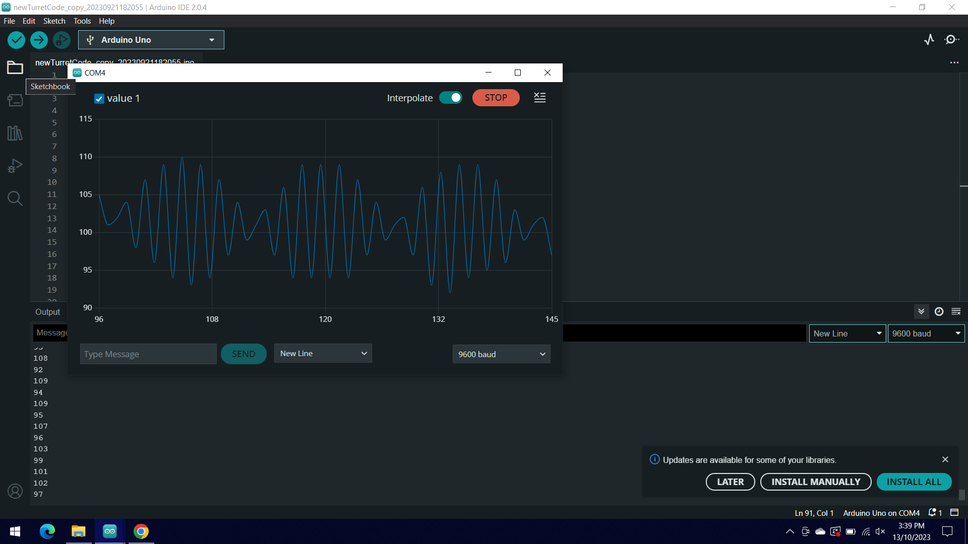

I have a joystick in my circuit and it has been returning a wave pattern even though all of the pins on the joystick are connected to my Arduino.
The waves look like this in the serial plotter (with interpolate on):
If you can help me out as soon as possible that would be great! (This is for a school project)

My guess is that your wiring is picking up noise at your mains frequency, and that you are not taking analogue reading at a high enough rate to see that it is a 50Hz/60Hz sinewave.
This is known as aliasing.
It looks to me as though you have a signal of oround 0.5V with approvimately 50mV of mains hum superimposed on it.
Using a function generator to give a 50Hz, 50mV signal, I can create a similar waveform to yours by taking a sample every 10.5ms. (just over half the period of the input signal).

oscilloscope trace: taking samples every 10.5 ms to illustrate aliasing

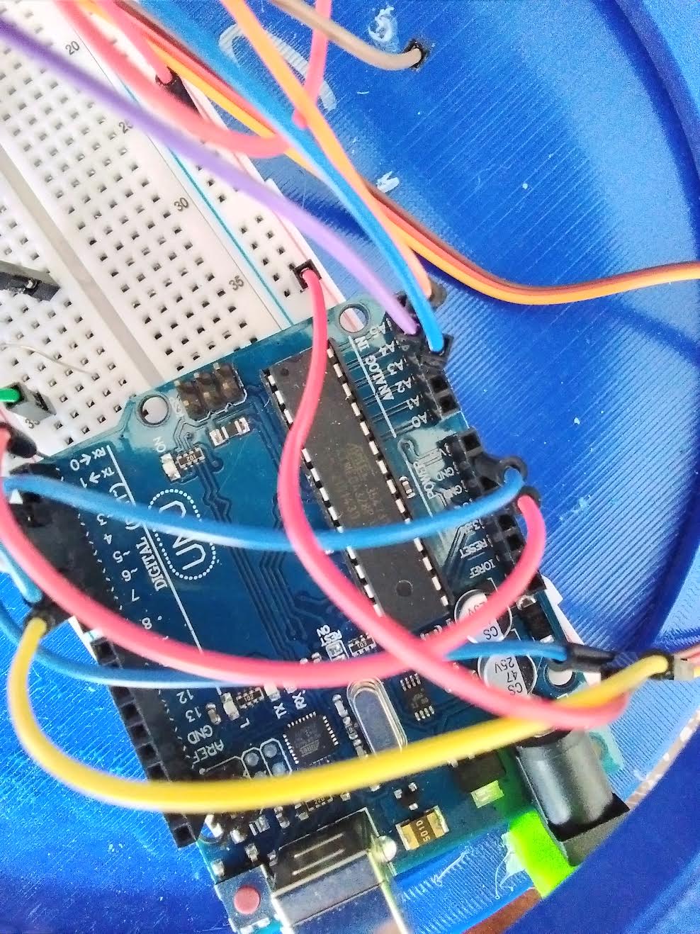

The actual setup looks like:
I'm not sure how well you can see these images.

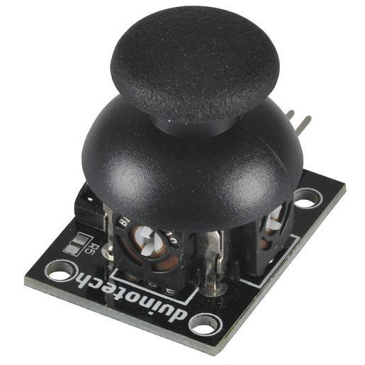

If it is the switching type joystick, rather than the pot type, with the joystick in the middle the inputs to the UNO will be open circuit.

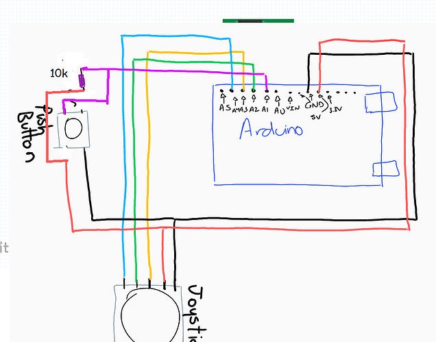

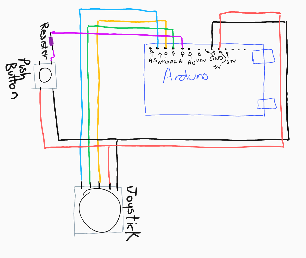

Please get your pen(cil) and paper out and post a copy of your circuit, a picture of a hand drawn circuit in jpg, png?

The joystick is one like this:
The circuit looks like:
I do have the wires soldered onto a vero board and then some wires connecting to the vero board, which then connects to a strip of rainbow wire

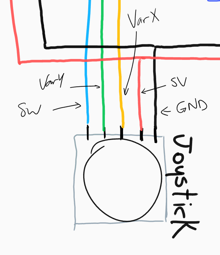

Please on your diagram mark the pin names on the joystick.
Your press button will not work like that.
Try this.
Thanks.. Tom.. :grinning: :+1: :coffee: :australia:
I am unsure what you mean by these statements.
I thought that the 5V had to be the opposite side of the one that is being given to the Arduino and the GND is parallel to the wire that goes to the Arduino.
From what you've drawn on my diagram the wire that goes to the Arduino connects to the 5V with a resister.
The labels added:

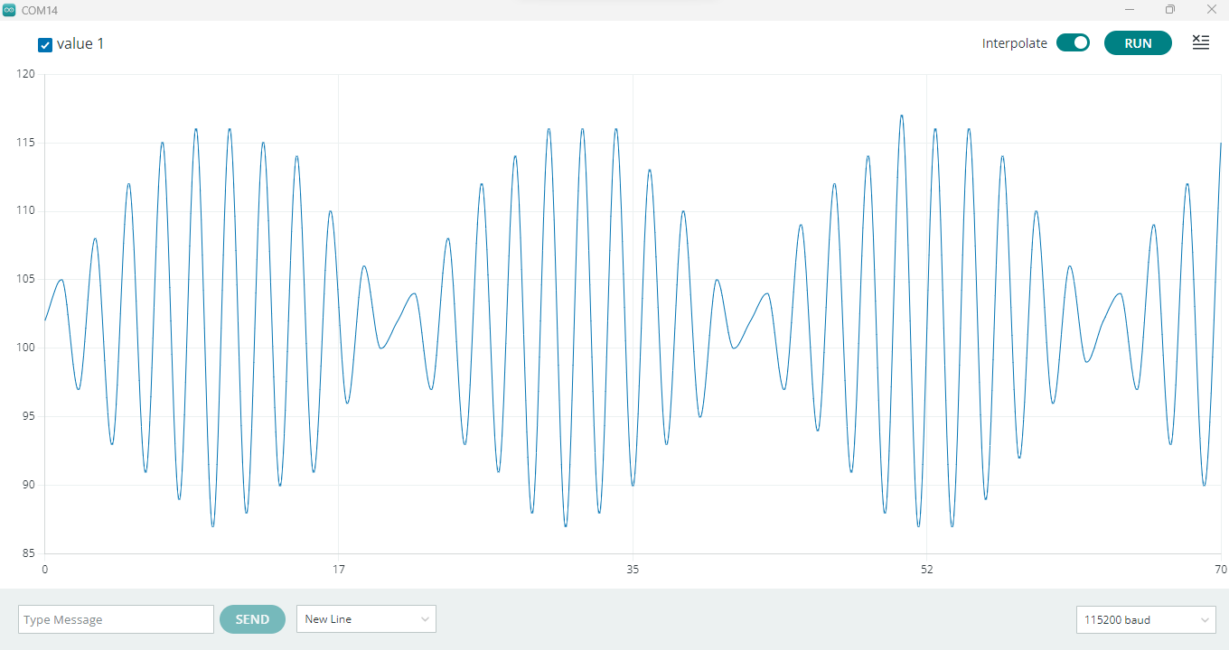

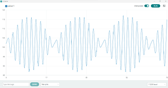

This does not work, I am given a wider version of the previous issue

can you paste an image of what you see in the Serial monitor ?
can you post better pictures where we see the whole breadboard and wiring?
How far is the joystick from the Arduino?
There is no gap in my red and black lines but I will move the jumpers closer to where I put the ones from the Arduino just in case!
What I see in the Serial monitor looks like:
There are LEDs and servos attached to the breadboard but they are currently not receiving any signals from the Arduino.
The Arduino is in my 3D printing "contraption" so it is difficult to get a good view of the ENTIRE board.
The Arduino is connected to the Joystick with about 1 metre of rainbow wire.

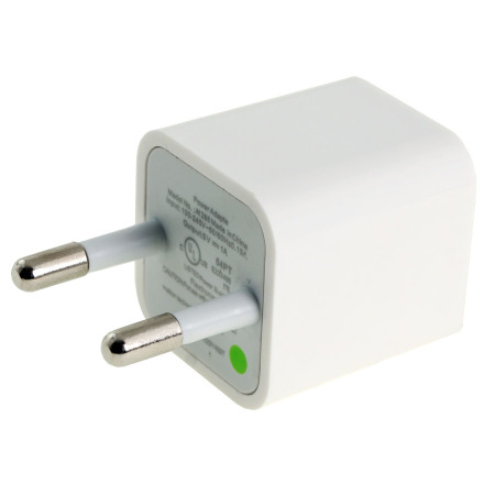

@tobiasjburford - Is this your power supply? These sometimes have noise problems. Is the problem also with USB power?
powercube
So you want me to have the black probe on the Arduino GND and red one on the A2, A3, A4?
I thought because the ground and signal is on the same side that when you press the button it will give the HIGH from the 5V on the other side (Like in the image), is this not how it happens?

It is with USB power coming from my laptop, this is the only power supply I've used
