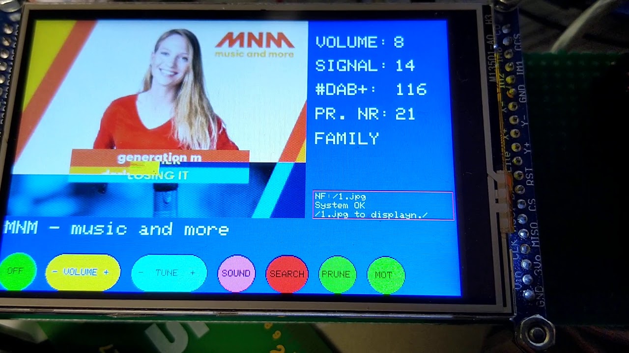

Hi all,
I have the Adafruit 3.5" 320x480 Color TFT Touchscreen Breakout.
With the supplied Adafruit_HX8357 library, it wotks well connected on a Mega board (displaying bitmap picture with the spitfbitmap example)
I would like to dispay jpeg picture. Fot that, I try to use the JPEGdecoder library where I chose the TFT_Jpeg example. It works, but the picture is very small as this library was created for the ST7735 Adafruit dispay which is 1.8" - 128x160.
In the code, there is commented lines for using a HX8357 based display (as the Adafruit TFT does) : using TFT_HX8357 library. But it doesnt work with Adafruit TFT, I think due to pinout. I replace the call to library by using Adafruit_HX8357. I also change in the renderJPEG routine the call to setWindow by a call to setAddrWindow as suggested. (setWindows do not exist in Adafruit library)
Finally, the code is well compiled, loaded to the board and it runs (information in the serial monitor) but ... no picture !
Hereunder, the code for including the library and creating the class TFTscreen:

Hi bodmer,
Thanks for the reply.
You’re right, there is a quite intensive use of startWrite and endWrite in the void bmpDraw of spitftbitmap.ino example (Adafruit_HX8357 library). I did not find any documentation on how to use these routines.
I added startwrite and endwrite around the while loop. Improving, a picture appeared on the screen … but far being perfect!
See result: Picture

I have attached a sketch that uses TJPGD
It loops through every *.jpg file in the /JPEGS directory on SD Card.
I have run it with Adafruit_ILI9341 on an ILI9341 screen.
I hope that it will build and run out of the box with Adafruit_HX8357 on your screen.
It displays landscape JPEGs and portrait JPEGs by changing the rotation to suit.
If the JPEG does not fit, it is scaled smaller.
Please let me know how you get on.
Or if you want a sketch that renders from PROGMEM Flash.
David.
show_tjpgd_SD_8357.zip (13 KB)
Hello David,
It is working!!, even the setRotation is causing no problems with your version.
Wow, thank you very much!

Hi David,
See next video for result with a DAB+ tuner and usage of the code you have shared with me, to display slideshow on the adafruit display;
Your video works well.
You could use FreeFonts for the text. Just remember to draw a fresh background because GFX only prints FreeFonts in transparent mode.
Do you store the JPEGs in Flash or on a SD ?
I presume that you only get text from the DAB broadcast.
David.
