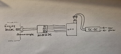

I have a small project to monitor oil and coolant temperature in my old-school carbureated car that has no electronics except for ignition and lamps.
I have an UNO, 2 Thermocouples with MAX6675 modules and a DC-DC step down converter set to 9 volts to power it all up without spikes in voltage. At least I hope that it does so.
My questions:
Since my thermocouples are of grounded type and they are physically connected to engine, If I'm powering the circuit from the car battery through DC-DC converter they read zeroes only.
  1. Am I correct, that I can eliminate this issue either by using external power supply (some battery) or by isolating thermocouples' tips from the metal?
If I go with isolating the thermocouples and using DC-DC converter:
  1. Is it correct to feed power from DC-DC converter to barrel connector on arduino or should I have gone for VIN pin directly setting the converter output to 5V?
  2. Should I add capacitors at the power input?
  3. Here Properly decouple Arduino in and output with opto coupler from engine noise - #12 by ununnilium I saw a circuit where all grounds are connected to car chassis.
    Should I do the same instead of connecting + and - from DC-DC converter to Arduino?
In principle, my circuit works - I tried it on my car already, powering with a 9V battery - but if I run the engine, ignition creates too much noise and all readings are messed up.
  1. How do I protect the signal? I read here about using ceramic capacitors. But where in the circuit do I put them and what capacity they should be?

There is a good app note AN2689 by ST on automotive electronics. reading it will help you a lot. Your old-school carbureted car will have a lot more noise problems then the newer ones.
You need the shielded cable to the thermocouple to be long enough so the amplifier module is as close as possible to your Arduino. Do not use ordinary shielded wire, but special wire made for thermocouple use.

Hi, @br1ght
Review the range of temperatures you are going to measure and look for a suitable RTD (Resistance Temperature Detector) type.
A thermocouple is a bit of overkill and the voltage from the couple is way down in the possible noise from an IC engine.
@Bwanna suggestion, using existing automotive conditioned sensors is probably the best solution.
Most automotive temperature sensors are RTD types.

Does the MAX6675 module connect one of the thermocouple terminals to ground? If so, the thermocouple grounding at the tip could have a big impact.

You could be getting a ground loop causing or contributing to your noise. I would have the Max, Uno, and converter going to a common ground bus and then going directly back to the battery. Try to run a block ground close to your sensor directly to the battery as well.
You can also try wrapping the whole thing in aluminum foil and then ground only one end at the battery ground to reduce EMI. It's important to only do one end as to prevent another possible ground loop. It's also a cheap test which is nice. If the aluminum foil works, you could use aluminum tape or other similar solution for the long term.
Did you extend the thermocouple using plain copper wire or the proper thermocouple wire?
Everything works fine right till... you start the engine. I can share this much with you. I have one of those DC to DC converters laying here just like the one you are using. Interesting as it I measure resistance between - Vin and -Vout I get bouncing numbers leading me to believe they are not common to each other. However when I power it up and adjust for 12 volts in and 5 volts out (or any voltage out) it matters not which common I measure from, I get the same Vout voltsge.
Next I would use decoupling caps on everything. I would use a 100 uF and a 100 nF on each power input including the DC / DC converter and the MAX6675 modules.
The actual MAX6675 chip itself data sheet does not reflect T- being grounded, however, the typical application circuit reflects -T being grounded. You may want to see how your modules are configured.
As you already know you apparently have grounded thermocouples.
Given a choice in applications like you have I prefer ungrounded with the sheath grounded and armored cable right to my temp transducer. This is where a scope would be nice to look for noise on supply side or sensor side. Keeping in mind everything works fine right till the engine is running and external power removed and you are on automotive system. Automotive electrical systems, especially older ones are known for noise. Start with decoupling capacitors.
