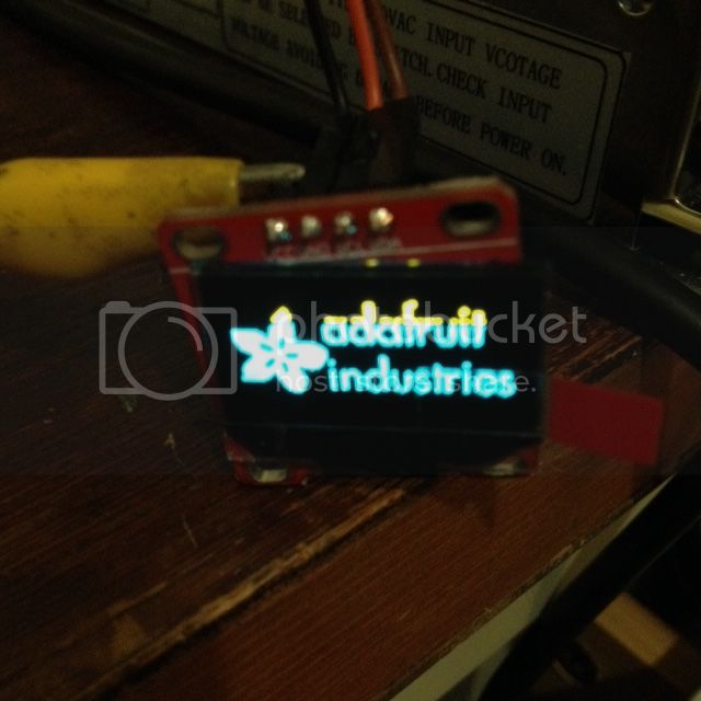

ok, I added a 100ohm resistor and the display worked using adafruit and u8glib.So at least I know the display works.
I'll try the reset circuit modification next.
got the reset circuit done.

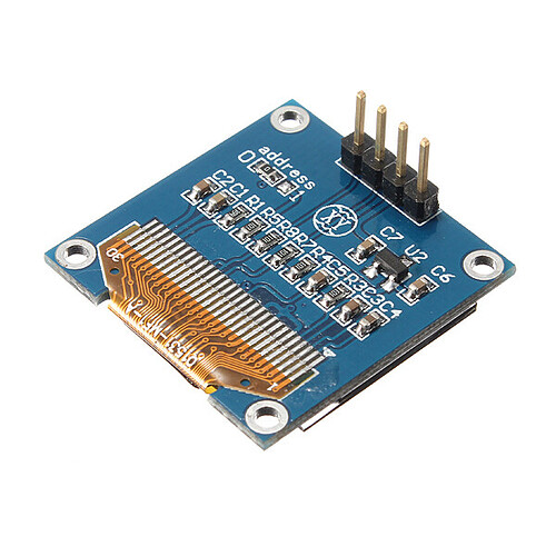

Additionally remark: I have some I2C OLEDs, but all of them worked without additional reset circuit (although all of them from other sellers)
Oliver

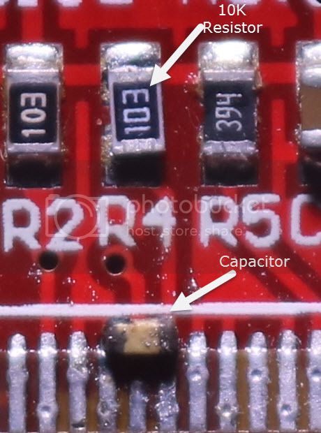

I'm thinking this is one way to tell if the oled board has reset circuit or not.
See this picture- count the pins from the right/bottom to pin 14. You can see the trace going to a capacitor C5.
compare that to the one, pin 14 goes to R4 and there are no capacitors nearby.
Hmmm nice finding, nice pictures.
I already consider the RC reset as a "not so good" solution. But even removing the C will make a very unreliable product.
Oliver
I think the rc reset is fine (actually clever I think). just my opinion.
I think it defeats the whole purpose of using I2C (or even SPI) if you have to carry another reset line.
