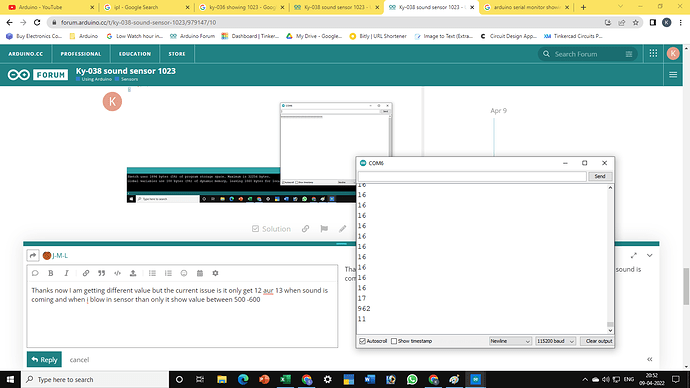

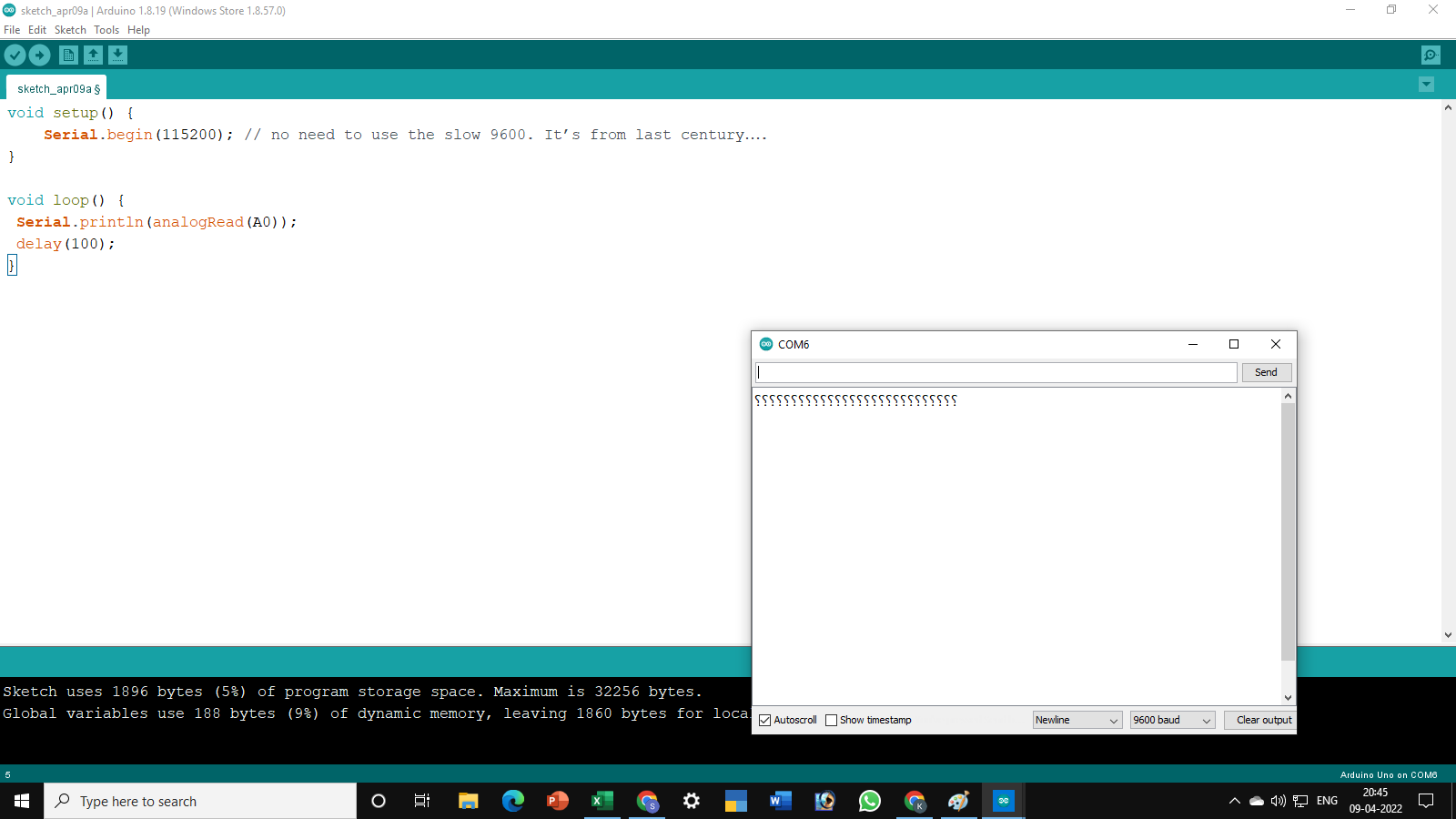

Sorry but it didn't work it is showing something like ?????????????? pls find ss when attached to A0 pin to A0 of Arduino should I change any pin
Sélect 115200 bauds in the pop up menu at the bottom of the monitor. It needs to match the value you set in Serial.begin()
Thanks now I am getting different value but the current issue is it only get 12 aur 13 when sound is coming and when i blow in sensor than only it show value between 500 -1000

Also to test, don’t make any noise and look at the values and then clap strongly in your hands next to the "microphone" (electret)
You might also want to change the delay to 10 to get more sampling
