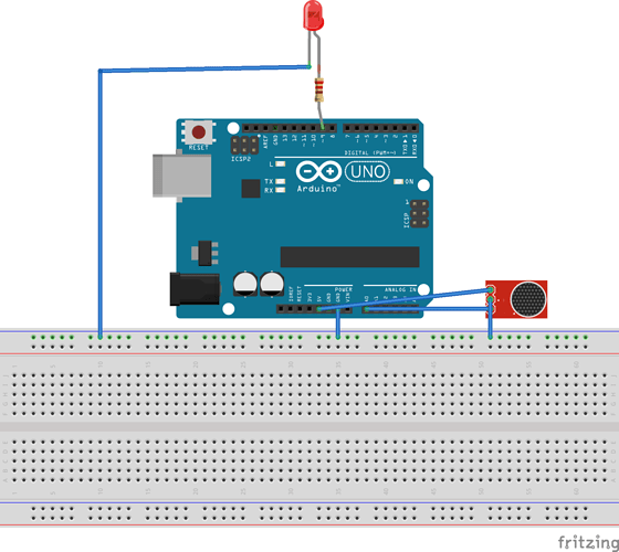

Hi everyone!
I'm new to Arduino and am having a problem with this sound sensor. With the code I created for the clapper(modified someone else's), the sensor won't work if I clap more than around 10cm from the sensor, but with a code that I found and only turns on the led light for 1 second and works even when I clap 5m away and I don't know how to do the same with the clapper script.
Thanks in advance for all help!
The clapper:

provide a link please so we can check the specs. You may need to use an amplifier.
Welcome top the group! Have you tried the digital output, it requires a lot less code and is less susceptible to electrical noise. Your clap is probably received as a narrow pulse by the analog input. When the pulse comes and when you read it are not coordinated so it is catch as can. The DO is always active when the clap occur You can use an interrupt to set a flag then in your main loop process the clap. Never do any processing in the interrupt service routine, it will eventually kill your code and you will miss things. Adding a cap of maybe 500 nF or so would help the analog input. Have fun!

You really should have taken a few seconds and read the code the OP posted. The version that they report working poorly reads the clapper signal as digital signal; the one that they say works much better reads it as analog signal.
The Fritzing image is misleading as usual (OP, do yourself a favour and DUMP THAT POS!) as it shows a 3-pin sensor while the KY038 is a 4-pin one. Very likely the OP is using the analog output for both, meaning the output has to go above roughly 2.5V for it to be detected as HIGH (yes, I know the datasheet says 0.6*Vcc but that's the guaranteed value, and here I'm talking about the actual voltage where the pin will read HIGH). That equates to an analogRead() threshold of ~500... where the more sensitive program uses a threshold of 40.
1: Make a schematic you can post
2: link to the sound sensor please
3: in your code you are using the "DEFAULT" reference. I'm assuming from the (despicable) Fritzing you are using a UNO. So change the reference to "INTERNAL" and you will get 4* better sensitivity on analog inputs.
