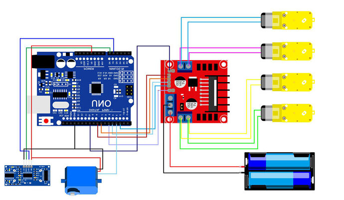

I have two L298 motor controllers. I am building a robot car using only one of them. I connected everything per diagrams and instructions, but the motors never worked. I tested the spare controller and it worked fine. Supply voltage to the L298 is from two 3.7 batteries that measures 8.4 volts. The module should handle that. I switched out the modules so that I had one I was sure worked.
Once connected to the Arduino, though, it quit working completely.
My question is, is there a way to reset the controller to work again? And/or why does this happen?

I would like to see the code too. But what's not clear from your description is when you say "I tested the spare controller and it worked fine." did you test that controller with the exact same Arduino and code and wiring as the one that failed? If not what exactly was different?
And to answer your direct question, no there is nothing about an L298N that can be reset. Problems with them are always code or wiring or you have done something that actually killed the controller.

Thank you for your reply. I don't believe it is a code problem since in no loner works on its own. That is, once the board had been connected to the Arduino it no longer worked by directly attaching the motor and battery. The power light on the board does come on.
However, here is the code. I haven't figured out the better way to post this, sorry.
Obstacle_Avoidance_Car.ino (7.17 KB)
OK. Maybe figured out how to post code.
Also, both boards were tested in the same way. I don't see how I might have fried the boards.

I would be extremely inclined to ditch that fairly complex sketch for testing, and just do a digitalWrite() high and low to the outputs without all that other stuff in the way.
The 298 chip drops 2V at least, up to almost 5V under appreciable current, so your 8V in will only be about 6 at best, perhaps only about 4.
From the 298 datasheet:
I would test it with the motors disconnected and leds (with resistors) from the 298 module output pins to ground to see if the output is sequencing as you expect.
And / or measure the voltage at the 298 module outputs under load and with no load, see what you get.
Thanks for the reply. I will try it when I have new boards to work with. The code is from a Robot Car Kit and I thought I could duplicate it with my own parts. Apparently not.
