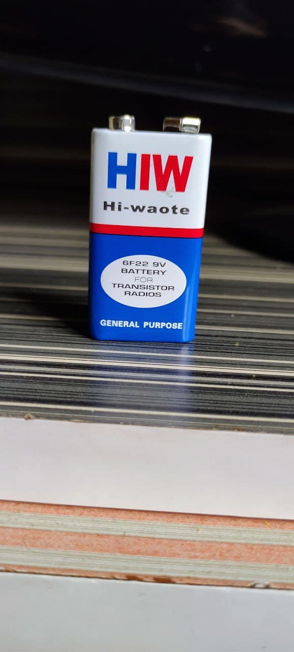

hi i am working with L298N H-bridge with my DC motor and arduino . but my motor doesn't starts when connected to L298N and if i connected my motor direct with battery it runs . I don't know what is the problem

so , please let me know how to solve this problem.
You have provided no data on the motor - at a minimum you need the stall current to figure out what power supply and motor driver is suitable. Most motors takes shed loads of current at stall, people usually utterly underestimate this.
The L298 driver is a poor choice at low voltages (less than 24V) as it wastes 3 or 4 volts. It also can only take an amp or so, some motors take 10's of amps.
The PP3 sized 9V battery is good for a few hundred mA, unsuitable for all but the tinest of motors (think 1/4 inch diameter motors). Even if such a 9V battery can spin a motor, its likely to droop from 9V down to 3 or 4V and get hot...
Are you using the 298 IC on its own or on a module?
Why haven't you got ENA pin HIGH?

because i tried that also, but nothing worked motor didn't rotate when ENA pin is connected and i saw in youtube videos in which they also didn't used ENA pin . FUNfact :- they were also using 9V power supply still they didn't used ENA pin. so i thought it would be good to follow their methods
