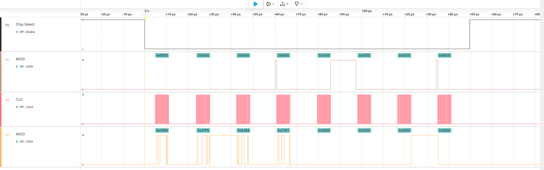

Hey all, I'm working on a program to interface with a development board I spun for an L9780 - wideband oxygen controller IC. At this point, I'm trying to get a consistent status register read back but continue to get some unexpected results that I'll explain below. This is the first "real" time I'm trying to write the SPI sequence for a chip from scratch, which is why I'd appreciate a sanity check!
The first question/verification I had was the SPI mode/setup. Searching around it looks like per the datasheet my clock is idle-low and the first data assertion (on SI) happens prior to the clock edge going high. This should correspond to a MODE0. Section 6.3 lists it as MSB first. The SPI timing table also lists 8MHz for the transfer rate; all the above should give me my config, correct?
My second question/verification was my use of the "SPI.transfer()" function. I made my way through this thread and understand the syntax behind it, so I think that part is ok.
Section 6.3.1 talks about the "REG" bit which is what's used to latch if the next SO frame contains the input reg, or the current "status" reg. This is why in my "get_status" function I'm sending out the request, and then doing another SPI.transfer (via the function) to read the result. Is this correct?
The reason I think I'm having issues is that for the status reg, the MSB is an ignored bit and then 3 version bits. Intermittently, when using my current code to test, I'm getting a change from a dec(1) value to a dec(2) value. This obviously isn't right, so while it appears I'm able to "communicate" in some form with the chip I'm guessing my formatting or byte order is FUBAR somewhere.
Is it the fact that the arduino is a little endian and I'm relating that to a SPI that transmits MSB first? From the various 64b words I've gotten back, that also doesn't appear to be the case, given the last byte also changes.
Also, per the datasheet there are some fixed (CB) bits and the SPI fault bits that should be giving some insight into the health of the current SPI frame. Both of these are giving me issues as well, which is further pointing me at that I've got something messed up with my SPI communication.
All reasons I'd appreciate some help! Below are some "outputs" from my current code just as a sample for what I'm talking about. The first few results I think are pretty well as expected from what values should be there on startup but again, I'm not 100% if what I'm getting back is "valid" anyway so...its kind of a crap-shoot.

I had posted this elsewhere and made some updates based on that feedback. I updated my L9780_SPI_xfr function to shift in the passed 64b word into a uint16_t array and then I also shift that back out into a 64b result. I'm not sure if that's necessarily the most elegant way to do it, but now at least I'm getting expected answers (with one other change).
One other thing that I had mis-understood originally is that this particular chip doesn't really have an "ignore" command on the input register so every transmission I need to send the "control word" in addition to updating the REG bit to set what gets shifted into the SO register for the next SPI frame. After making those two changes I can request the SI register after sending a command and get the same result echo'd back.
I'm still having some issues to chase down but the actual SPI coms appear to be functional now. When requesting the status register, the SPIF1 fault bit is set, which correlates to a "SPI command data length error" when requesting the status register. The datasheet states that the expected length is [64 + n*8] bits which I'm not 100% clear on, so I need to do some more digging into that. I'm unsure if the "n*8" part is just a nomenclature thing, or if there's other bits it's expecting beyond the 64b of the control/command register and that's why I'm getting a length fault.
Hey, Jim.
I was wondering if you'd made any more progress on this? I took on a pet project and chose the L9780 controller for running an NTK sensor. I've done the hardware side of things first and now I'm getting into the programming side. The documentation hasn't been so helpful, and I've only managed to stumble on your post here and on the ST site.
I've been busy with other projects but it's still on my radar. I haven't attached a logic analyzer yet to verify my coms which is kind of the last "make sure it's all working" part I need to do yet. I'm also working on the heater PID control but have been running into issues (which is why i need to verify the data stream). Also, I'm using an LSU4.9 so some of the below may be different depending on the sensor but....most of it should be the same.

I have started to play with the L9780 and it looks like most of you are far more advanced than where I am currently. I have a PCB and I can attempt to talk to the device. From a physical hardware level, my CS, MISO, MOSI, CLK look really good and I do get some correspondence
but for some reason it seems the SPI Fault bit is always set. I am missing something obvious so hoping one of you experts may be able to assist.
I power on the device and then I send a 64bit control value (0x0000 0000 0000 8000) which is only populated with the respecitve CB1 and CB0 values.
The 64bit status returns indicates that immediately I have an SPIF issue. Find attached a screenshot of my transmission. Any help would be greatly appreciated.
