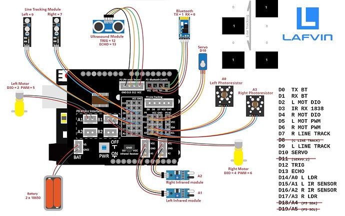

In this topic I will be posting links, drawings, sketches and observations to operate or isolate problems particular to the Lafvin 2WD V2.2 kit which uses the TB6612FNG (NOT the L298N) motor controller and the JDY-16 Bluetooth module - the other devices are common digital and analog sensors (IR remote/receiver, IR proximity sensor, line tracker, SG90 servo, HC-SR04, LDR/photoresistors).
Best thing to start with, LAFVIN Contact Us page if the following information does not solve your problem;
The OEM product download page where you need to find the 2WD V2.2 link:
This zip file contains the user manual and all the sketches.
The manual is illogically arranged, with sketches inserted as images, wrong devices under wrong lesson headings, and referencing the wrong parts.
The Lafvin system drawing is incomplete. I added missing information with some useful notes. D3, D8 and D11 are unused in V2.2 so I speculated on their possible use in the drawing. D18 (A4) and D19 (A5) can be used for any I2C device or bus.

Motors and Motor Controllers - TB6612FNG
(see below for L298N)
Motors cause many kit-build problems due to insufficient power, inefficient motor drivers and confusion in wiring (which motor, wire polarity, motor direction). LAFVIN 2WD V2.2 uses the TB6612FNG which seems efficient with power usage. The kit's battery holder is for two 18650, but does not have a BMS, so keep measuring the 18650s or install a 1P2S BMS. If you did not get 18650s or do not want to install a BMS, use 6 x AA batteries (6x1.5vdc=9vdc) to form the kit power supply.
Motor sketches 1 through 4 will test motors (left/right) and directions (forward/backward) individually. Motor sketches 5 through 8 will test motors (left/right) and rate (PWM/speed) individually. Motor sketch 9 will test both motors in both directions. Motor sketch 10 will test both motors in both directions while changing speed.
All motor sketches will run within setup() to allow for observation of one movement happening one time. This avoids scrambling for a way to turn the motors off - usually pulling the power supply and some wiring. This also helps verify the correct motor and polarity without excess load.
The LAFVIN 2WD V2.2 TB6612FNG motor driver is controlled like this (NOT the L298N):
// TB6612FNG PIN STATES                         MOTOR DIRECTIONS
//  LDIO  LPWM  RDIO  RPWM  RESULT              LEFT      RIGHT
//  HIGH  rate  LOW   rate  forward             forward   forward
//  LOW   rate  HIGH  rate  reverse             reverse   reverse
//  LOW   rate  LOW   rate  rotate left         reverse   forward
//  HIGH  rate  HIGH  rate  rotate right        forward   reverse
//  LOW   LOW   LOW   rate  skid forward left   stop      forward
//  HIGH  rate  LOW   LOW   skid forward right  forward   stop
//  LOW   LOW   LOW   rate  skid reverse left   reverse   stop
//  HIGH  rate  LOW   LOW   skid reverse right  stop      reverse
//  LOW   LOW   LOW   LOW   stop                stop      stop

  Serial.print(" us | Distance = ");
  if (distanceCM >= 400 || distanceCM <= 2) { // Maximum 4m, minimum 2cm
    Serial.println("Out of range");
    spacepad(distanceCM);
    Serial.print(distanceCM);
    Serial.print(" cm | ");
    spacepad(distanceIN);
    Serial.print(distanceIN);
    Serial.println(" in");
void spacepad(float value) {
  for (int i = 10000; i < 10; i /= 10) // divide value 10 fold each iteration
    if (value < i) Serial.print(" ");
Ultrasonic bargraph
#define trigPin 12
#define echoPin 13
#define width  100 // adjust for screen width
#define speed  100 // adjust for speed of graph
long duration;
int distance;
  pinMode(trigPin, OUTPUT);
  pinMode(echoPin, INPUT);
  // create trigger pulse
  digitalWrite(trigPin, LOW);         // turn off pulses
  delayMicroseconds(2);               // pause before transmitting
  digitalWrite(trigPin, HIGH);        // transmit pulses...
  delayMicroseconds(10);              // ...for 10 microseconds
  duration = pulseIn(echoPin, HIGH);  // time the echo
  for (int i = 0; i < (duration / (3 * width)) + 1; i++) { // create graph of echo
    Serial.print("*");
  Serial.println();
  delay(speed);
(More to come. Just taking a pause from uploading)
