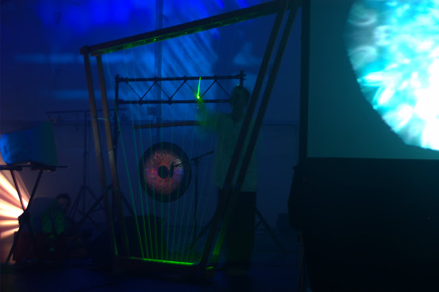

I've been exploring Laser Harps on and off for the past 6 years. I built one a few years back using a PIC micro, some phototransistors, a 150mW Laser, some basic software, glass beam splitters and a hell of alot of elbow grease in building the frame and getting it all going (photo below). I'm now developing a new design. Initially I intended to sell my existing harp frame and laser but wanted a more elegant and safe laser design before flicking it off. So along came Arduino and this is what I have been up to so far:

3.5m X 3.6m Harp Frame (Packs down to very little)
