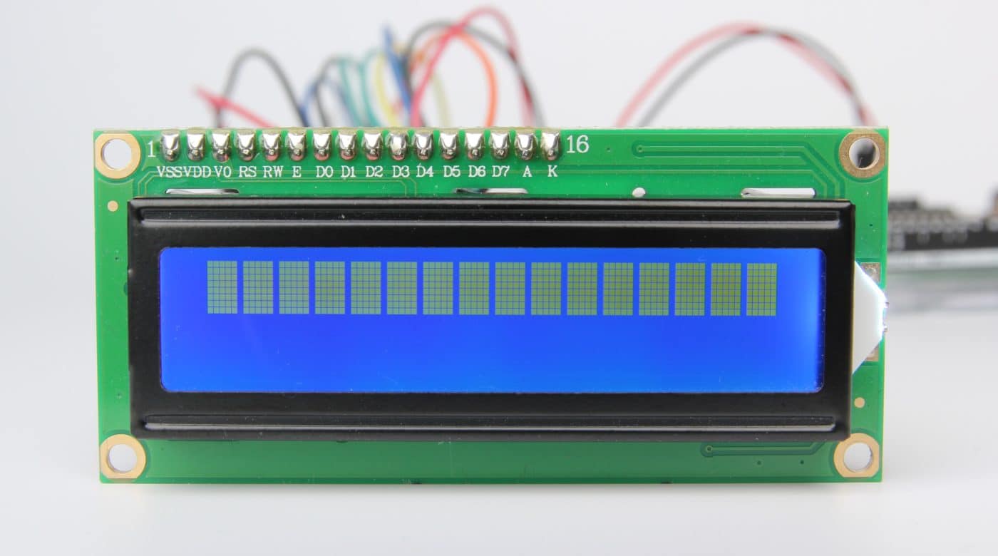

So, I have the 10k potentiometer connected to VD and it is showing the 16 bars on the first row, whose brightness is dependent on the amount of energy going through the pot.
Here's what it looks like:
Sorry, it is currently night for me, that is the best I can do right now.
Wait, I just figured it out, I don't know what I did though, but now it is displaying random stuff like: 0,o,?,!,etc.

You shure that R/W pin is connected to Ground? And using D4 - D7 pins...
Wow!
That is an amazingly clear picture. With nicely soldered header pins.
So I gather it is not your display. :astonished:
This display tells you the power connections to the backlight (16, 15) are working so the backlight is on, the power connections to the LCD (pins 1 and 2) are correct and the contrast (pin 3) is correctly set.
What is not working is the code on the Arduino controlling the display so either the code is wrong or the connections to pins 4,5,6 and 11 to 14 are not correct.
