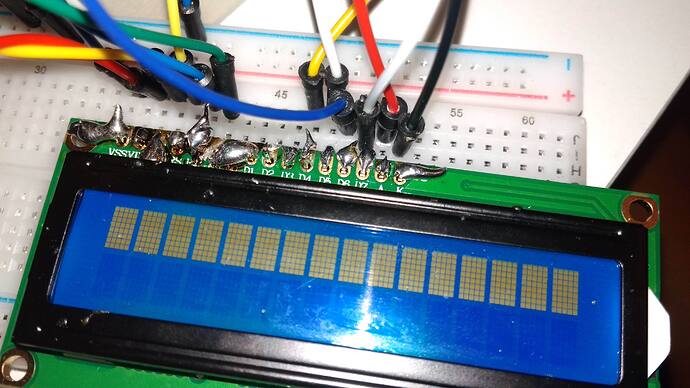

I just started to setting up my LCD display, but I have a problem.
This is my code.

I soldered every single small metal piece to the board. Maybe I made a mistake?

@piplikoc's IMG_20190924_203650.jpg:
I very much recommend against trying to use that LCD module until you have fixed all the solder joints. You have bridged some of the pins together with solder blobs and it's possible this could result in damage to the LCD or Arduino (it may have already done so).
I only soldered 3 pins together, which are D1, and D0 and the E, because I thought I will only use the E, because I only use the D7-D4.
We can only repeat pert's advice.
Get help with soldering from someone with the skill. Until it is connected properly, there is no point whatsoever in attempting to operate it. :astonished:
It is probably not damaged, but foolish to proceed in this state.
Learning how to solder is a useful skill.
Either ask a neighbour for help or study videos on the Internet.
Many Ebay modules come with ready-soldered header pins. Make sure that you check the photos before buying.
LCD modules with I2C backpacks are normally soldered.
Regular non-I2C LCD modules are not soldered.
