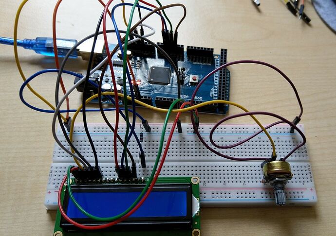

I triple checked how I wired lcd to arduino. Also, I used the code from examples:
#include <LiquidCrystal.h>
const int rs = 12, en = 11, d4 = 5, d5 = 4, d6 = 3, d7 = 2;
LiquidCrystal lcd(rs, en, d4, d5, d6, d7);
  lcd.begin(16, 2);
  lcd.print("hello, world!");
  lcd.setCursor(0, 1);
  lcd.print(millis() / 1000);
You may have a bread board with a break in the power rails. You need to jump across the break as shown in this image.
groundFungus:
Not "may" but absolutely does. That is exactly what the image shows when viewed at full size.
