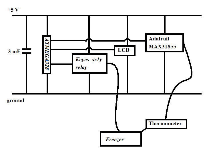

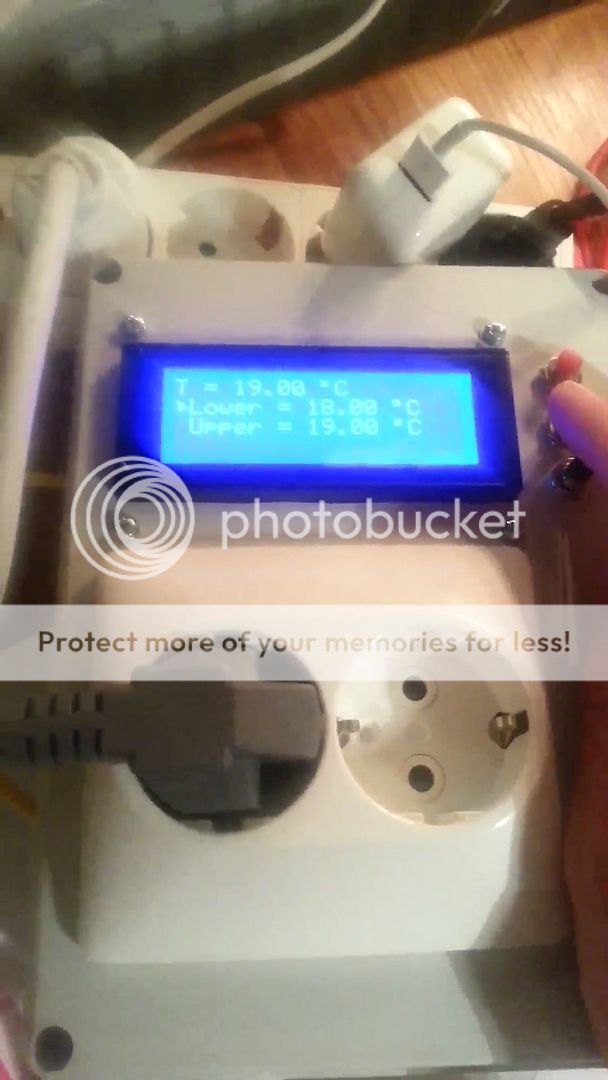

I've built a thermostat that works as I want it, except that the LCD goes bananas sometimes (not always) when the relay switches between on and off (which connects/disconnects a freezer). Thought I'd post it here, to see if anyone else has seen this kind of behaviour (see attachement).
Everything is fed via a single USB-cable. I've tried placing capacitors (3 mF) at the connection of the power supply (USB-cable), but doesnt help (maybe it's a bit more robust now, but still get the behaviour seen in the video from time to time).
When the LCD goes bananas, the thermostat still works as intended, but I can't read the display.
Anyone has any idea what is happening? Could it be the LCD that jumps from 4-bit mode to 8-bit mode? Can that even happen after it has been initialized? (I've no idea how the LCD actually works, I just use the arduino library) I mean after the relay switching, the code seems to work, but somehow the LCD doesn't interpret the data sent to it correctly...
Thankful for any ideas, I'm running out of my own...
Edit: Too big file to attach apparantly, link to the video clip here:

The very first thing I would ask, is that you post a schematic of what you have connected.
One thought comes to mind. Do you have a driver to turn switch the relay or is it directly connected to the Arduino I/O? Do you have a flyback or catch diode fitted across the relay coil?
Fof
Sorry, I haven't drawn any proper schematic, the attached file is a simplified "one-line diagram" (not showing pin numbers and multiple cables to e.g. the LCD). If you'd like a more detailed schematic, I can fix that, but it'll take some more time. Please let me know if you want me to do it.
I have connected the relay directly to the microcontroller and with no extra protection diode, but I believe that is included in the relay I've bought (see schematic diagram here: http://tinkbox.ph/sites/tinkbox.ph/files/downloads/KEYES%205V%20Relay%20Module%20KY-019.pdf ) but I might very well be wrong.

As you guessed, your relay is fitted with a catch diode, so that idea is out of the window.

You say that you fitted a 3mF capacitor. I presume you mean a 3uF capacitor, as 3mF would be a big cap or a small supercap.
I would suggest a 10uF in parallel with a 100nF.

Your schematic says you have 5v. Where are you reading 3v or 3.3v?
  1. your 3m cap can stay there, across the 5v supply. Try fitting a 10uF and a 100nF cap directly on the LCD board, across the LCD supply. Get the polarity right with the 10uF.

The relay module the OP is using (post#2) interfaces directly to the Arduino and is driven by one of the I/O pins. He does not need an optocoupler.
Thanks for all input. It's 3 mF capacitor over 5 V, not 3 uF (actually 3 parallell connected 1000 uF).
I've tried capacitors at the LCD supply also, didnt work.
I have however solved it now, thought I'd post it here in case someone else runs into the same issue (seems a lot of posts have this problem, but the only solutions that has been suggested is to place diodes and capacitors everwhere, and it doesn't seem to actually help anyone in the posts I've read).
The LCD apparantly has three possible states ( Hitachi HD44780 LCD controller - Wikipedia ), where
State3 may occur, for example, if a prior control was aborted after sending only the first 4 bits of a command while the LCD was in 4-bit mode.
As the thermostat is working even after the display goes crazy, I think it's because the LCD doesn't interpret the data sent to it in the right way. So, if a disturbance comes from the relay during the writing to the LCD, you might end up in the incorrect state of the LCD.
The way I solved the problem was to first measure the length of the disturbance (seems to be some tens of ns), then apply a delay in the code, right after changing the state of the relay. I used 100 ms delay, but the measurement suggests I can reduce it severely, but I don't mind waiting having it at 100 ms so I'll keep it there.
So, in the code I updated the last part to (I only added the two lines "delay(100);"):

Skitskraj:
I've built a thermostat that works as I want it, except that the LCD goes bananas sometimes (not always) when the relay switches between on and off (which connects/disconnects a freezer). Thought I'd post it here, to see if anyone else has seen this kind of behavior (see attachement).
The problem is not with the LCD, the likely cause is that you are using a relay without proper contact arc suppression. The problem is worse because you are driving a highly inductive load (the freezer). Although you might expect the relay to provide galvanic isolation, in the electromagnetic higher frequency domain the noise can couple into your circuit by many parasitic paths, especially if it has been built with long wires and inadequate grounding.
Without adequate suppression a seismic burst of electrical noise is being coupled into your driving curcuit (Arduino + LCD) when the relay changes state. The amount of noise will depend on when the relay opens/closes in the mains sinewave cycle. The inductive load multiplies the problem greatly because trying to stop a current flowing in an inductor is like expecting to stop a flywheel rotating at high speed instantly, which it does not want to do!
In cases where the electrical noise induces a differential voltage on the power supply rails, then decoupling hides the problem well, but in the decoupling world bigger capacitance is not always better as the ESR (Effective Series Resistance) increases with capacitance and thus high frequencies are not decoupled. This is why in digital systems a combination on capacitors is used, 1nF, 10nF and 100nF for the really high frequency decoupling, and bulk capacitors starting at 47uF deal with the low frequencies.
In cases where the electrical noise induces voltages on data lines then this messes up any communication that is happening at the time. In this case decoupling on the power rails has little effect. Inserting a delay after switching the relay is simply ensuring no communication occurs during the electrical "storm" that occurs when the relay changes state.
Note that the root cause has not been fixed by inserting a delay, it is just stopping the noise from affecting communication by ignoring it for a while. This is a bit like driving a car and finding you hear a loud bang when the brakes are put on, the solution is not to get some ear plugs and carry on driving!
Without investigating the real cause, the reliability of the thermostat will be poor, eventually the relay will fail due to the lack of suppression (causing arcing at the contacts) and potentially the freezer will either stay on (welded relay contacts) or more likely will not get switched on (burnt out contacts).
