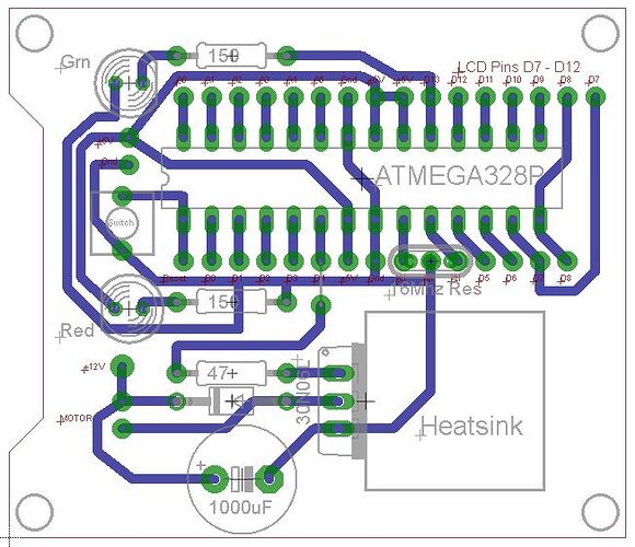

I'm having a really strange problem that I hope someone here can remedy.
I have put together a guitar pickup winder with an LCD interface. The motor is turned on via a relay, and is driven via a PWM signal from the Arduino to control speed. Motor is 12V and isolated via a MOSFET (logic driven by PWM).
The LCD is a JHD204A (20x4) hd44780 compatible display. As the motor turns, the LCD indicates # of turns from interrupt input from an optointerrupter (and some other tid-bits).
The problem is, sometimes in the middle of the operation, the LCD starts to display junk characters, and sometimes when the motor goes low (off state from relay), display goes blank and arduino must be reset. This only does this when the motor is under load, ie. if I detach the drive belt, let motor run without a load, and turn the shaft by hand to increment turns, everything works great.
I'm using a computer supply for the power supply to run both the motor and the logic. The PS is rated +12V @ 26A and +5V @ 30A which should be more than enough to run what I need. The DC motor is out of an old printer.
Could this be an effect of a current change, caused by the motor, which affects the state of the LCD? I'm baffled.
