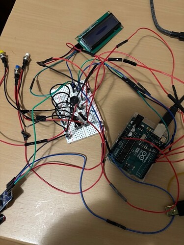

I am using the following components to build an Arduino alarm clock. The breadboard is numbered from 1-30 and from A-J.
  1. Arduino Uno R3
  2. I2C 1602 LCD Display Module
  3. Real Time Clock (RTC) module (DS3231)
  4. 3 x Twidec PBS-110-X6C Momentary Push Buttons
  5. Gikfun Passive Electronic Buzzer (EK2146)
  6. 3 x 10kΩ resistors
  7. Breadboard
  8. Jumper wires . The three Twidec PBS-110-X6C Momentary Push Buttons are connected to Arduino pin A8, A9 and A10 through the breadboard holes 5A, 10A and 15A. The Buzzer is connected to Arduino pin A11 through breadboard hole 20A. The LCD module is not working. Kindly advise.

Can you verify your LCD is an I2C LCD? Would you post a picture of the back side of the LCD?
That is good. It is an I2C LCD. Please upload a picture of the wiring so we can see each end of every wire.

Unreadable picture. Draw the circuit.
The code does things (but needs work), so the problem is in the wiring.

Three 10K ohms resistors, 5V buzzer , I2C 1602 LCD Display Module and Real Time Clock (RTC) module (DS3231) were used for this alarm clock. The LCD does not work.
Does your sketch upload?
Do you see any LEDs on the Arduino light?
For the LCD only, look at the pin labels of the LCD... where do the four pins go?

Have you tried one of the example codes that comes with the Library you are using.
Don't try and write a lump of code to try and get everything to work at once.
Write code JUST for each if your peripherals and get it working, before putting them together one at a time.
So start with your display and a library example to prove you have communication with it and control.
Have you run an I2C scanner sketch to verify the I2C address of the display?
Yes, I uploaded the sketch. Jumper wires from the VCC and GND pins of the LCD are connected to the breadboard power rail at line 25 (+ and - respectively). There are also GND connections from 5G, 10G and 15G to the (-) rails respectively. The lights on the Arduino and the D3231 are on but the light on the LCD also flickers.
