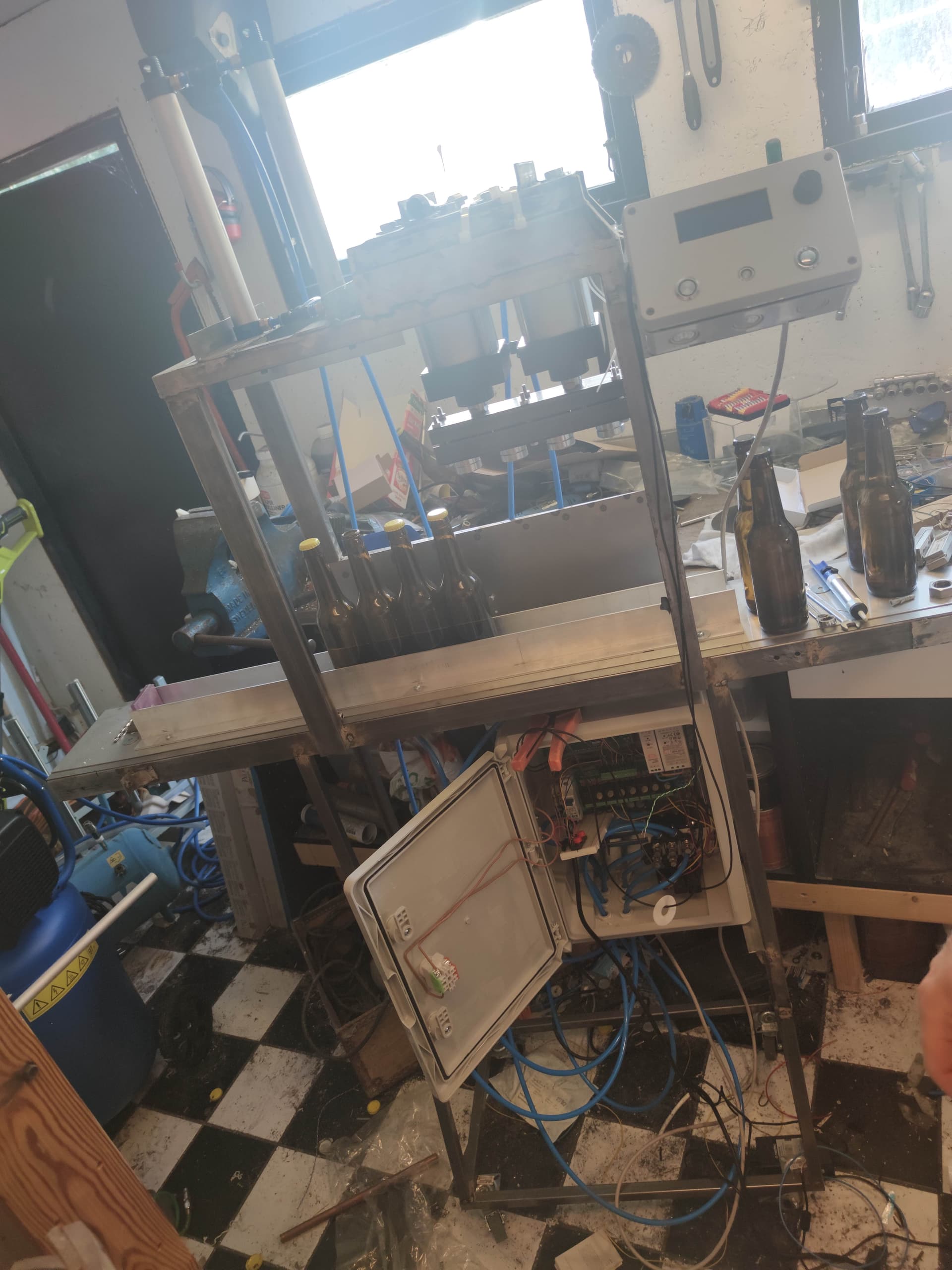

hi everyone.
so i think i have read all the threads on the web about LDC problems and trubbleshooting without any luck. I have a 20x4 LCD that's communicates over the I2C bus. the cable that I am using is one wire shielded for the SCL and SDA. they are totaly seperated from each other and from the rest of the cables in the project. the length of the cable is about 80cm. i have tried to use 4.7k omh pullup resistors due to the length of the cable but it did not work. tried to disable the Serialmoniter, but no luck there either. i have also tried to use diffrent power source for the arduino and use power to the LCD from the source, but no luck. i am suspecting that the problem might be in the code and not a hardwear problem. or what do you guys think???
good to now: every thing can work fine for like say 5-6 loops and after that the problem occurs. some thimes the arduino resets itself and somtimes i don't.
