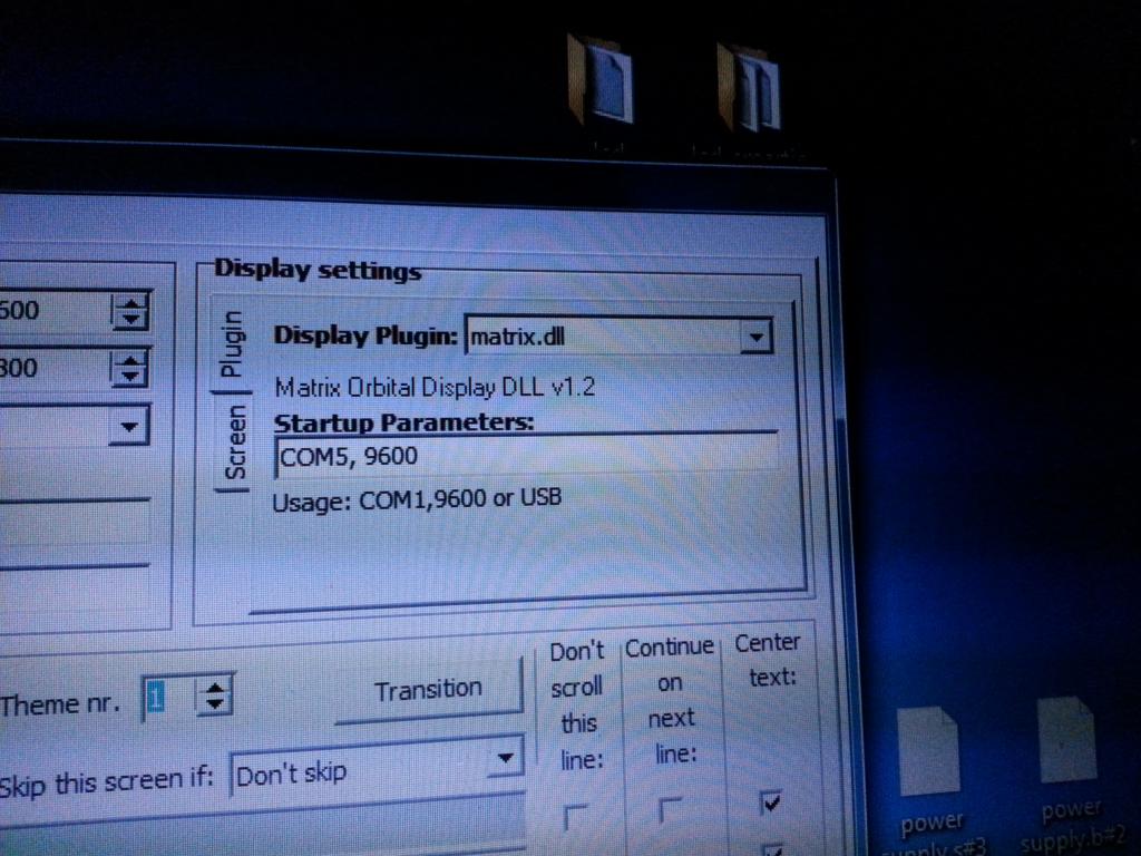

hello everyone. I’ve done lcd smartie on arduino nano (atmega328) for my PC.
everything seems to be working fine until I open lcd smartie program. all I got is screen full of zeros.
every connection is ok.
tested with 2x16 and 4x20 lcd’s with same result.
project is based on this one: http://waihung.net/lcd-smartie-through-arduino/

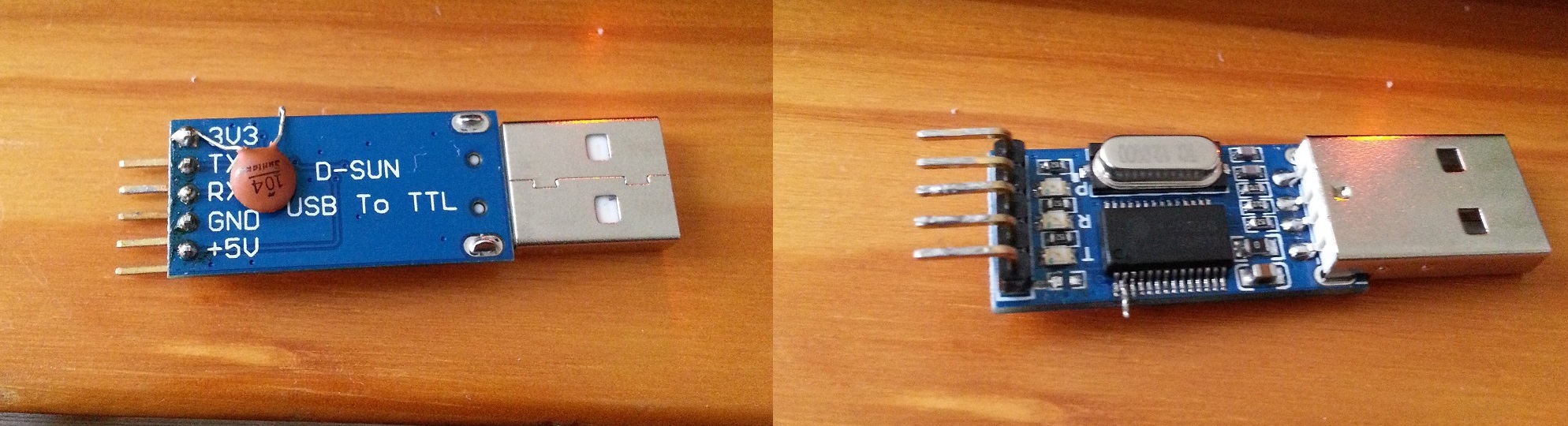

nothing happens. when i send command as you said RX led flashes for half a second and there is nothing changes on the screen. probably thats why i cant connect to lcd smartie and winamp. another thing is i have to use arduino ide under ubuntu, windows gives me error. Lcd proc doesnt show anything aswel.

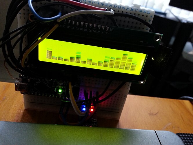

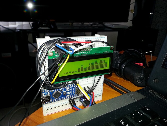

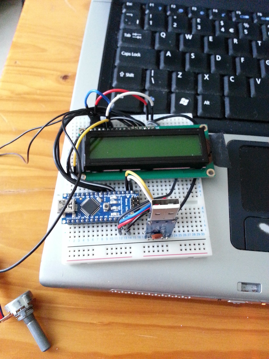

problem solved! ftdi chip seems to be faulty. arduino is now connected via modified prolific 2303 usb to ttl device. lcd smartie still doesn't work but winamp plugin from 2nd post is working fine. :)
great :) can you post a photo of your spectrum analyzer?
lcd smartie in my first post show just lcd full of zeroes, now i have screen full of threes.
pics of analyser
